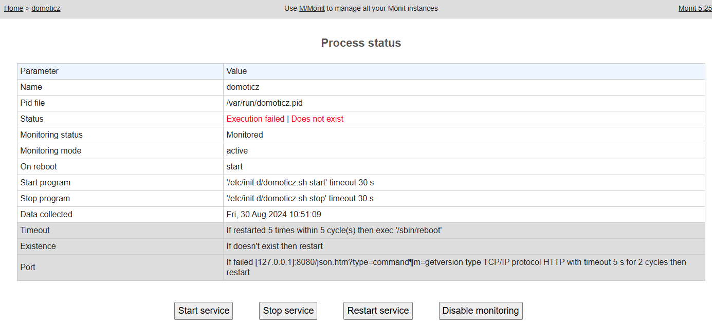

When I check the Monit web page, I get the following error:
After more than half an hour, the raspberry has been rebooted based on the "If 5..." statement and then after 5 minutes the domoticz server is finally started.
What is wrong in the "if failed..." statement and how can I test this on the raspberry (terminal).

There is still a difference between a reboot command and a power failure. After a reboot command domoticz is running, after a power failure domoticz is started, but not running:

Also the pidfile at /var/run/domoticz.pid is not available
After 5 minutes Moni becomes active and now restarts domoticz. Domoticz is now running again:
