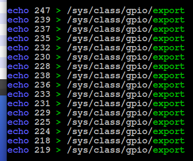

I seems that the value equals the GPIO pin assignment in linux minus 256
Linux GPIO reference
Screenshot from 2024-08-17 20-24-17.png (22.8 KiB) Viewed 756 times

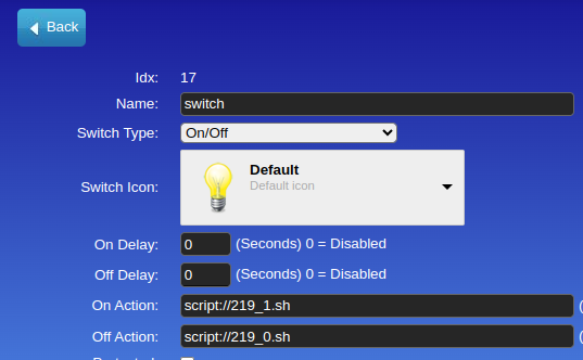

When making a dummy switch and assigning a script that turns on and off the GPIO output all works fine.
With script
With script
Screenshot from 2024-08-18 08-33-09.png (35.72 KiB) Viewed 747 times
