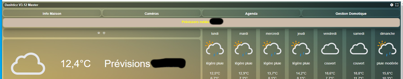

Good morning,
I just installed version 3.12 Master
Issue :
I only have access to the first 'Weather' page
The different tabs are inaccessible

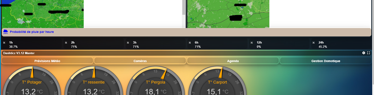

Page 1 and 2 'Weather + Home Info' are on the same page when starting !
I did a git checkout . + git pull
I haven't modified any files in dashticz!
Page 1
Page2

There is a small bug in master 3.12:
If you have dial that uses a domoticz device that doesn't exist then Dashticz will stop rendering additional blocks.
It has been fixed in the beta branch.
or, try to locate the unknown device.

I found the intruder
How to install the beta branch?
HansieNL
Posts: 964
Re: Version 3.12 - Bug
Post by HansieNL »
If you did install via Terminal you can change branch by following commands in the Dashticz main folder:
git checkout beta
git pull
Otherwise you have to download the beta.zip and unpack in Dashticz folder. You can cleanup Dashticz folder before unpack. BACKUP CUSTOM FOLDER
