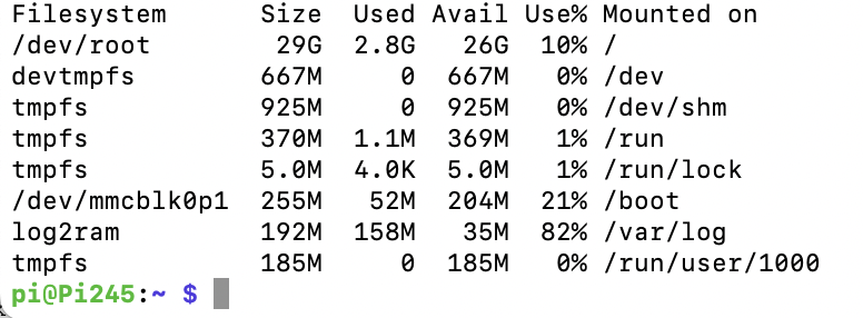

On my Pi-4 + Domoticz on SD card i use Log2Ram as a cache for log files protecting to much read/write to this SD card. When i first started with Pi and Domoticz I had crashes after several months "blowing up" my SD due to much read/write actions.
Since the use of Log2Ram I had not have any SD card problems anymore. I make a SD card copy once a year to a new SD card to prevent card damage.
Since some time I notice on 1 Pi-4/Domoticz configuration that the reserved Log2Ram memory is at 100% use after 2-5 days. Below picture is after 2 day of cleaning up /var/log/ of all log files and do a reboot (first stopped Domoticz and Log2Ram service) On other Pi/Domoticz (I have 4 in total) the used memory is 17, 70, 11 % and the last reboot was over more than a month ago.
On the "problem" Pi I have about 400 Zigbee devices listed (125 used) and some errors in the log. I am in the proces of setting up a new Pi4 with external 2.5" SSD with and installing Mosquito, Zigbee2MQTT and Domoticz on/with Docker, managed by Portainer (not successful until now)
I am looking for a "quick fix" by resetting the logfile's once a week to prevent the memory to run full.
Has anyone an idea on how to clean up/ free up the reserved Log2Ram memory?

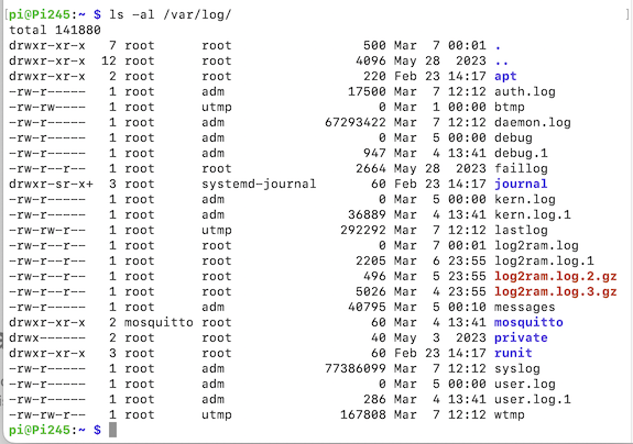

Do a
and look for what is taking up all the space, and take action on that file(s) by logrotate.
And the same of course for any subdirectory.
ls -al /var/log/And the same of course for any subdirectory.

Below the result

So 'daemon.log' and 'syslog' are too big.
It looks like you have logrotate installed, check with
Both should be enabled.
Also look in the dir '/var/log/journal' there might be some big files too.
In '/etc/logrotate.d' there should be a file called 'rsyslog' or 'syslog'
This is my file:
Most important parts are 'rotate 1' and 'daily / weekly'
With that you control how many rotated files are created and if it is done daily or weekly.

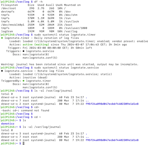

You missed output from
And to see the size of files you should do
sudo systemctl status logrotate.timerCode: Select all

i Changend 4 to 1 and weekly to daily
requested output:
requested output:

Logrotate.timer is enabled, so logrotate will work.
Now you have to wait until logrotate is run, normally that will be somewhere after midnight.
Your content of /var/log/journal looks good,but depending what is in the dir f95f.........
You could now manually delete those big files and reboot, just to be sure that the /var/log will not reach full before logrotate runs.

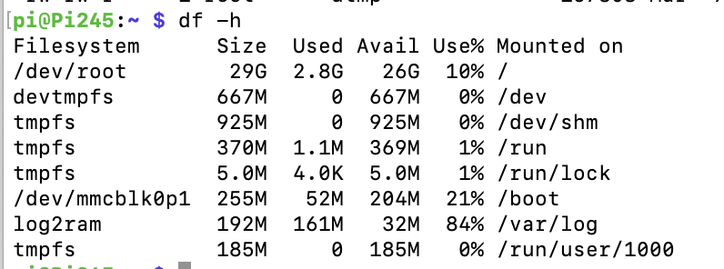

All the Log2Ram reserved memory is full the f95f..... directory is filled with *.journal~ files
I changed the weekly to daily and rotate from 4 to 1
below the last result, while 12h ago the mem use was 50%
PS: i removed all the files in the f95f... directory and now the mem use is 50% again (df -h)
pi@Pi245:~ $ df -h
Filesystem Size Used Avail Use% Mounted on
/dev/root 29G 2.9G 25G 11% /
devtmpfs 667M 0 667M 0% /dev
tmpfs 925M 0 925M 0% /dev/shm
tmpfs 370M 39M 332M 11% /run
tmpfs 5.0M 4.0K 5.0M 1% /run/lock
/dev/mmcblk0p1 255M 52M 204M 21% /boot
log2ram 192M 192M 0 100% /var/log
tmpfs 185M 0 185M 0% /run/user/1000
pi@Pi245:~ $ cd /var/log/journal
pi@Pi245:/var/log/journal $ ls
f95f24a098d047ecb6f4402309e1d1e8
pi@Pi245:/var/log/journal/f95f24a098d047ecb6f4402309e1d1e8 $ ls

Find which file(s) grow the fastest.
See which are currently the biggest by
It can't be that difficult to find the file(s) that grow fast and should be corrected by some sort.
Did the logrotate run and are the files daemon.log and syslog now small?
sudo du -h /var/logDid the logrotate run and are the files daemon.log and syslog now small?

This was at +- 13:00h. After ls -la I did a rm *.* in this directory, so it was empty
logrotatie should run this night, I check tomorrow

deamon and syslog are not present. it seems files in f95f..... are the ones growing now

Do a
Remove the journal files (don't remove the journal dir),
Perhaps lower the 100M in the /etc/systemd/journald.conf to 50M and do
Did the logrotate do its job?
sudo systemctl stop systemd-journald.servicePerhaps lower the 100M in the /etc/systemd/journald.conf to 50M and do
