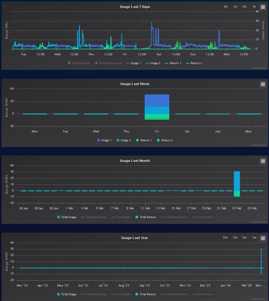

njlammerts wrote: Thursday 22 February 2024 13:26 @Waltervl: i think also the reading wil continue on the same Domoticz. But now Domoticz is showing metercounts of the current meter. The new meter wil start (almost) at 0 (zero) i think, does these different values not conflict?
@psubiaco: I dont know if the Dutch meter has the "Replace" function (i think you mean the P1 meter and not Domoticz)? Maybe dutch users can confirm?
The change from current readings to zero will cause a large negative value in the 5 minute counter (in the meter table) and a large positive spike in the daily values (in the meter_calendar table) because the daily switchover routine looks at minimum and maximum to determine the daily change value.
The 5 minute counter will disappear automatically after a few days (depending on your history setting). The daily value you will have to remove yourself the day after the meter switch. In the current domoticz version this can be done by the shift-right-click method on the graph. From then on the values will be calculated correctly again.
If you don't want to delete the daily record but update it to the correct values, then you have to use sqlite3 or the sql browser. Check the references or do a search.

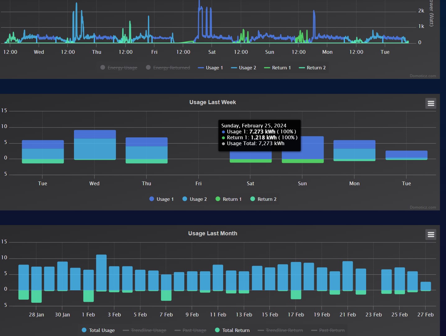

These are the "spikes" . is deleting the spike from " usage Last Year" enough to remove the spikes from all 3 diagrams.
I dont mind to loose some exact values for a day or so, if the month/year data stays correct.

Re: Physical Change Energy Smart Meter
Last week, last month and last year all use the same data.
Only last days use different data.

Re: Physical Change Energy Smart Meter (Solved)
Post by njlammerts »
I deleted the "Usage Last Month" data spike and this deleted also the "Usage Last Week" data. I can live with this.
