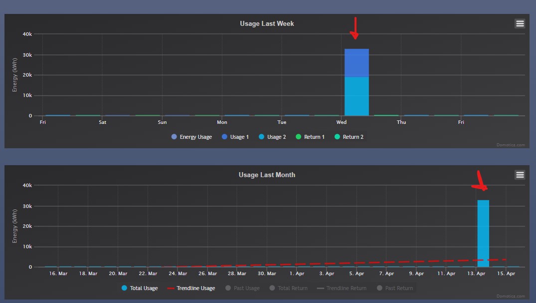

Wednesday my smartmeter was replaced at gave a huge spike in my data. We also went from 1 phase to 3 phase.
How can I get rid of this 'mountain'? This screws up my history :-(
Can someone help me please? I do not understand what to do with sqlite

Check this topic for a reference... viewtopic.php?p=288572#288572
But as you are using a P1 meter it will be more difficult as it has more counters.
Perhaps it is better to make a new P1 Hardware Gateway in Domoticz resulting in new devices with fresh data from the new P1 meter and disable the old P1 Hardware gateway

Thanks to viewtopic.php?p=276025#p276025 I was able to fix the glitch :-)
