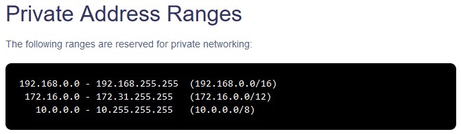

194.165.16.73 is a local network Ip adress. Are you sure that it does not come from one of your devices?

That's not correct, this IP is not in one of the private IPv4 range.Daik wrote: Thursday 08 February 2024 10:21 194.165.16.73 is a local network Ip adress. Are you sure that it does not come from one of your devices?
whois 194.165.16.73Code: Select all
role: FLYSERVERS GLOBAL NETWORK OPERATION CENTRE
address: 50th Street, Global Bank Tower, Suite 1801
address: Panama-
