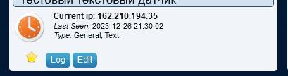

Re: Is there a Dynamic DNS script?
Post by habahabahaba »
-- 123
		timer = {
			'every minute' -- just an example to trigger the request
		httpResponses = {
			'GettingIP' -- название должно совпадать с методом Callback ниже
	logging = {
		level = domoticz.LOG_INFO,
		marker = 'GettingIP',
	    local ip_url = 'https://api.ipify.org/?format=json'
		if (item.isTimer) then
			domoticz.openURL({
			    method = 'GET',
				url = ip_url,
				callback = 'GettingIP', -- see httpResponses above.
			}).afterSec(1)
		if (item.isHTTPResponse) then
			if (item.ok) then
				if (item.isJSON) then
				    local jsonParser = require('JSON')
					local json1 = jsonParser:decode(item.data)
                       local currentIP = json1['ip'] --
                        local devIdx = 40 -- idx of your text device with current ip
                        domoticz.devices(devIdx).updateText('Current ip: '..currentIP)
                        domoticz.log('Current IP: '.. currentIP, domoticz.LOG_INFO)
                        --- uncomment and put your data
                        --[[domoticz.openURL({
            			    method = 'POST',
            				url = '<YOUR POST URL WITH CUR IP>',
            				callback = 'Updating IP', -- see httpResponses above.
            			  }).afterSec(1)]]--
		        --OOOPS
				domoticz.log('ERROR', domoticz.LOG_ERROR)
				domoticz.log(item, domoticz.LOG_ERROR)

Great!! Thank you very much! Going to try tonight 👍🏾😁
