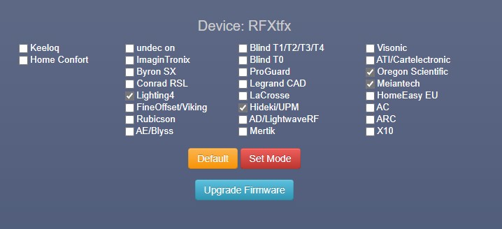

The picture shows your Domoticz access.

Thanks but not sure you''ve added anything that wasn't in the question!
The link is where I found the manual that I mentioned and the picture is simply Domoticz way to set the protocols. I just used RFXmngr to troubleshoot in Windows so I could view the logs with no other clutter from other Domoticz stuff.
