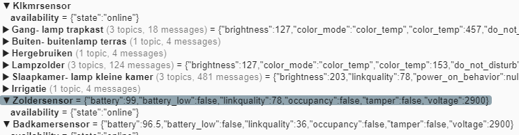

The first one is showing a screenshot from the MQTT Explorer where you can see that ther is a difference between the Klkmrsensor and for example the Zolder sensor'
The second screenshot shows the values of the Zoldersensor. The values at Klkmrsensor are not displayed

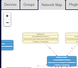

The last screenshot shows the state of connection in the Zigbee network
