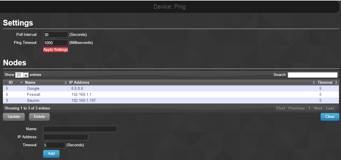

I use System Alive Checker (Ping).
Below example from Domoticz Wiki:
Simple question: is there any way with script or better w json url to change "Sauron" device to other value ?
Why I need that ? My Mikrotik router has a backup LTE ISP uplink with dynamic IP address. I wish to send obtained IP address to domoticz every time it is changed.
Any hint ?
Best regards to all
Posts: 7020
Domoticz version: 2026.3
Re: System Alive Checker question
Change the value from the web ui and check with F12, section network the API call to modify. It could be that part of the url is base64 encoded

This is the url:
http://192.168.2.xxx:8080/json.htm?type=command&param=pingerupdatenode&idx=<hardware idx>&nodeid=<node ID>&name=<name>&ip=<ip-address>&timeout=5

Post by ilex »
@Kedi: You have made my day - thx !
"status" : "OK",
"title" : "PingerUpdateNode"
