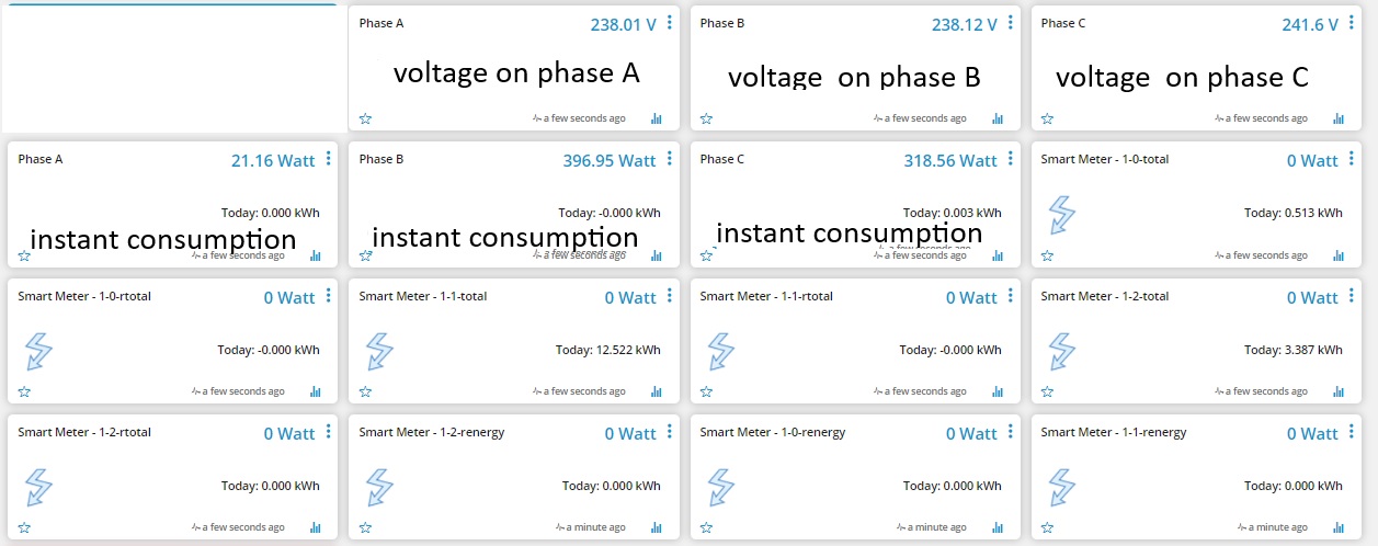

I use a shelly 3em, integrated in domoticz with Shelly MQTT.
I don't know how to see the total consumption per month or at least per month. for example from 01.01.2023 to 31.01.2023. is there someone who can make me a script or another solution for the event, even for a fee?
Shelly 3em monitor

Shelly 3em monitor
- shelly 3 EM.jpg (140.44 KiB) Viewed 3883 times

- Posts: 6691
- Domoticz version: 2025.1
Re: Shelly 3em monitor
Just go to the report page of the device (click on Log and then Report) and you can go back for years. See wiki page https://www.domoticz.com/wiki/Managing_ ... ice_Report
Also the Log page gives already a lot of data

I also have a Shelly 3EM via Shelly MQTT. How do you get the "instant consumption"? I only have things like voltage, ampere and powerfactor, but not the actual power in watt.
Do I have to calculate it via script? I am strugling with this.
- gizmocuz
- Posts: 2712
- Location: Top of the world
You could use MQTT Auto Discovery and create config objects for the shelly MQTT outputs
For example:
homeassistant/sensor/shellyem-1-0/power/config
homeassistant/sensor/shellyem-1-0/total/config
Make sure all id's are unique and you group the power/usage like above
Example for the voltage
homeassistant/sensor/shellyem-1-0/voltage/config
I am using a application called MQTT Explorer.
Make sure the config objects you publish with the 'retain' topic set, so the will always be there
Once they are in Domoticz you should get monthly year graphs/reports

imautohuttraeger
- Posts: 172
- Joined: Saturday 14 March 2020 13:40
- Location: Germany
Thank you! I will have a look on it (will last a while until I will have enough time) and try if I can work it out. But I think it will be too sophisticated for a guy like me, who is just a user with very little programming skills and knowledge.
However, what I managed meanwhile is, to sum up Voltage, Ampere and Powerfactor via dzVents Script (a lot of copy and paste and help by ChatGPT
