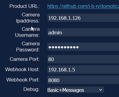

What to fill in here?
JBN
Posts: 41
Joined: Saturday 13 July 2013 8:00
Location: Sweden
Re: Python Plugin: Reolink
Post by JBN »
I am sorry, the name is likely confusing. I'll look into that.
The webhook is created in the camera by the plugin. Thus the Webhook host is the (from the camera) reachable ip-address of the Domoticz server.
In my setup I use 10.0.0.* where my door camera is on 10.0.0.9 and my Domoticz server is 10.0.0.2 (the webhook host). Note that you cannot use 127.0.0.1 (since that is not reachable by the camera).

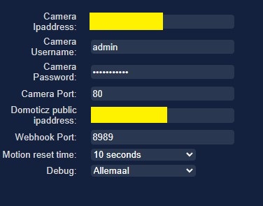

Do i need to change a setting in the doorbell? Because i have an error.
Webhook Host, is my domoticz IP, Webhook port is domoticz port.

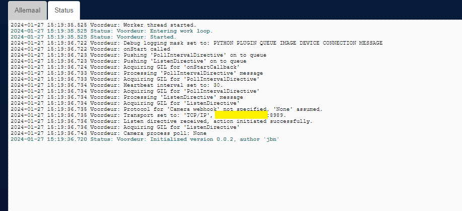

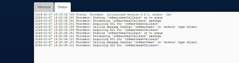

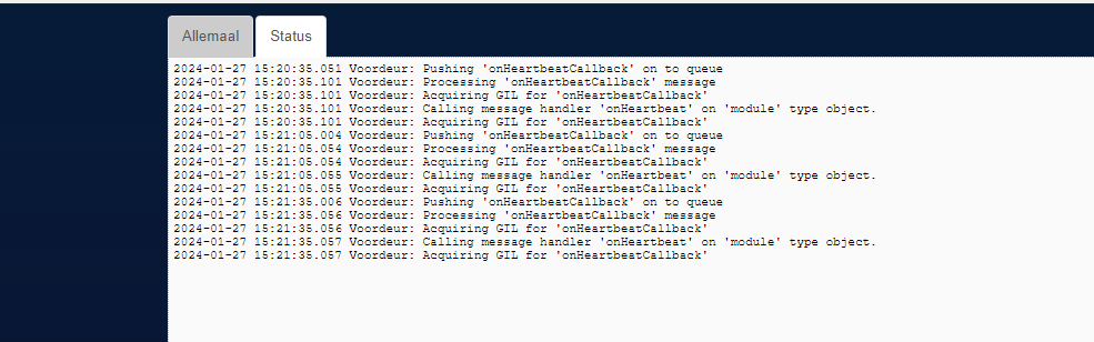

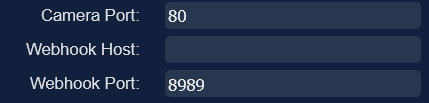

I have installed the Reolink plugin, i am using a frontdoor videocamera connected via POE. The problem is dat the plugin is not making new devices.
First i had to modify plugin.py, line 134. I changed 127.0.0.1 in the ip adress of the domoticz pi. I left the port on 8989.
If i restart Domoticz the plugin starts without errors (i think) but it doesn't make new devices. What can be the problem?

You need accept new devices in setup of domoticz
Domoticz v2024.1 on Synology Docker host, RFLink, ESPEasy wemos D1, Ecodevices, relays x8, dahua doorbell, reolink cameras ....
Rik60
Posts: 141
Joined: Sunday 25 June 2023 21:54
Domoticz version: 2025.2
Post by Rik60 »
dyter wrote: Saturday 27 January 2024 18:13 You need accept new devices in setup of domoticz
Thanks.
I tried, accept new devices (was already set green but still pushed the button for 5 minutes) did not help. In this 5 minutes i restarted the plugin also. No succes....
JBN
Posts: 41
Location: Sweden
Post by JBN »
In the latest version of the plugin (do an update) I have changed to python3 and changed from 127.0.0.1 to self.webhook_host.
@Rik60 - You should find the devices under the Devices tab. If Domoticz can not create the devices the error message is "Unit creation failed, Domoticz settings prevent accepting new devices."
The logs you have posted is the complete log from the plugin?
