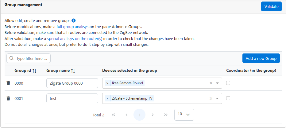

I am not able to add devices to a group. I can make a new group but not able to add devices to the group. The device disappears after I press on validate.
I did a group scan on devices etc. The groupslist-xx.json file is writable, I see that the group (test) is added to the json.
It worked before but it seems that it is failing after updating to Plugin: 6.3.011
The extra group I had disappeared after the update.

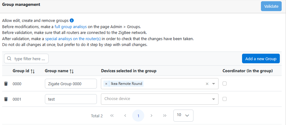

After click on Validate the device dissapears

Addition: After some further testing it seems that I cannot add the devices that were earlier in that disappeared old group.
I can add other devices that were not part of the old group.
Can I reset group settings on a device?
