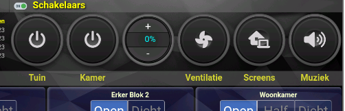

Is it possible to have thxt under a dimmer like with the other switches ?
2023-02-19 09_58_19-Fully Remote Admin.png (83 KiB) Viewed 388 times

madpatrick wrote: Sunday 19 February 2023 9:59 Great !!
You mean to have the title of the block below the block, like for instance your Tuin and Kamer example?
How did you create it in your example?

Correct.
I'v this added to the configuration
custom.js
// TITLE BLOCKS
blocks['Title_Lichtschakelaars']= {width: 12,type: 'blocktitle',title: 'Schakelaars',image : 'switch-on.png'}
blocks['Title_Garbage']		= {width: 12,type: 'blocktitle',title: 'Afval',image : 'garbage.png'}
blocks['Title_Tuin'] 		= {width: 2, type: 'blocktitle',title: 'Tuin'}
blocks['Title_Woonkamer'] 	= {width: 2, type: 'blocktitle',title: 'Woonkamer'}
blocks['Title_Hal'] 		= {width: 2, type: 'blocktitle',title: 'Hal'}
blocks['Title_Ventilatie'] 	= {width: 2, type: 'blocktitle',title: 'Ventilatie'}
blocks['Title_Screens'] 	= {width: 2, type: 'blocktitle',title: 'Screens'}
blocks['Title_Muziek'] 		= {width: 2, type: 'blocktitle',title: 'Muziek'}
custom.css
/* ---------------  Text below Dial ---------------  */
div[data-id*="gr_tuin"] span[class*="device"],
div[data-id*="gr_kamer"] span[class*="device"],
div[data-id*="dimmer_hal"] span[class*="device"],
div[data-id*="ventilatie"] span[class*="device"],
div[data-id*="Slide_1"] span[class*="device"],
div[data-id*="Slide_2"] span[class*="device"]		{font-weight: bold; color:yellow !important;position: fixed;font-size: 20px;top: 130px;width: 140px;}
