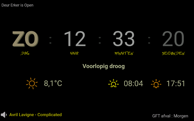

You can make a dummy text sensor in Domoticz and the text can easily confiured in Dashticz
I've several text " blocks" in Dashticz and the text is controlled via a Dzvents script to update the text or control the text
Here an example of Dashticz Screenssaver
