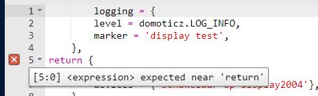

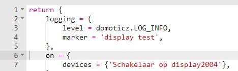

RonkA
Posts: 126
Joined: Tuesday 14 June 2022 12:57
Domoticz version: 2025.1
Location: Harlingen
Re: get a global (or persistent)counter to work in dzVents-script
Post by RonkA »
Hi, if i run this immediatly this error occurs:

Replacing 1ine 1 gave:
So i placed line 5 to line 1:
,error gone but in the log this gives immediately:
Error: EventSystem: in display Script #1: [string "return { ..."]:3: attempt to index a nil value (global 'domoticz')
I have the funny feeling my dzvents is broken.. :?

Posts: 735
Domoticz version: 2024.1
Post by willemd »
I think the order of the sections matters. You should put the logging section just before the word "execute".
If I run below script I get the "testing the buttonpress script" message in the log file and the device state.
Always good to put log messages in between while doing development.
        devices = {'Schakelaar op display2004'},
    data = {
        buttonPress = { initial = 1},  -- this is the definition of the persistent variable for counting the number of times the button is pressed
    logging = {
		level = domoticz.LOG_INFO,
		marker = 'display test',
        domoticz.log('testing the buttonpress script', domoticz.LOG_INFO)
