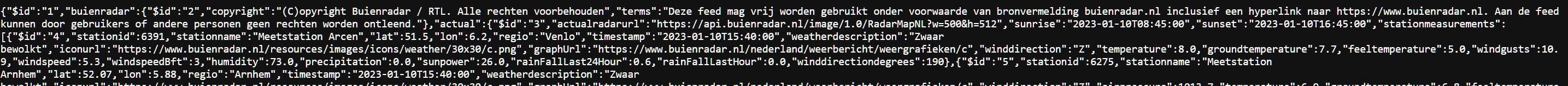

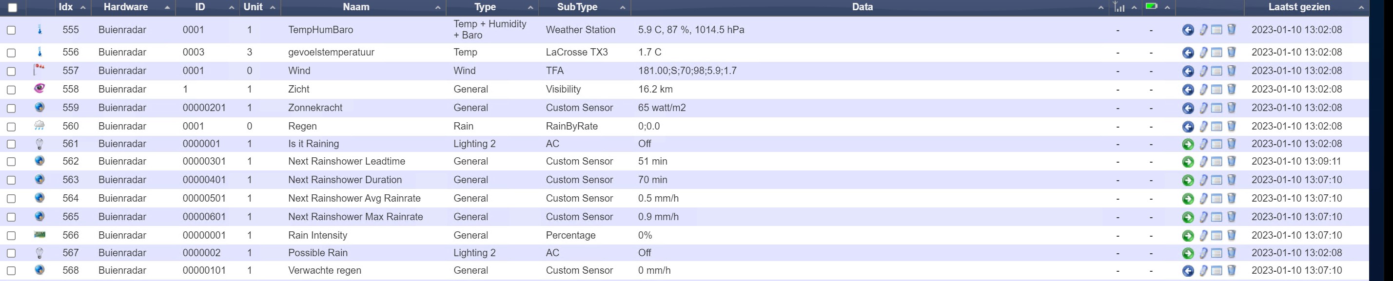

Hi there.. i do notice that the normal temperature feed has stopped with BR? I only have these left ?
best, dikke
best, dikke
- Schermafbeelding 2023-01-10 130943.jpg (290.49 KiB) Viewed 1646 times
- FireWizard
- Posts: 1967
- Location: Voorthuizen (NL)
Re: Buienradar stopped updating at 1:30
What do you receive, when you enter: https://data.buienradar.nl/2.0/feed/json in a browser?
hi there... loads of this !
- Schermafbeelding 2023-01-10 160615.jpg (223.81 KiB) Viewed 1629 times
willemd
- Posts: 736
- Domoticz version: 2024.1
The normal temperature is part of the TempHumBaro.DIKKEHENK wrote: Tuesday 10 January 2023 13:11 Hi there.. i do notice that the normal temperature feed has stopped with BR? I only have these left ?
best, dikke
The one that is not in your list is the ground temperature, but looking at the sequence of your idx numbers it has never been there.
But then again, you have visbility in the list, which I don't have.
My buienradar is updating normally.
ah ok, so this is basically all BR has to offer? If thats the case, fine, then i know all is well. Since i do had also ground temp, and that also dissapeard.
