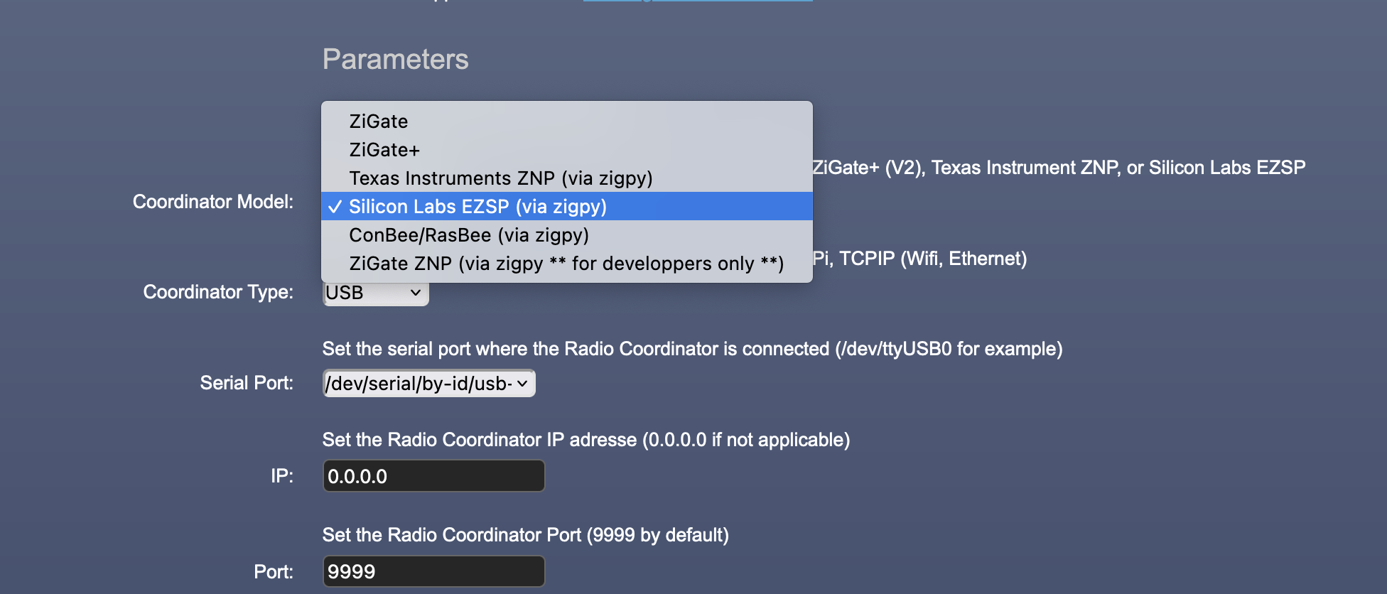

Update --------ZigBeeforDomoticZ plugin Admin Interface
Version 6.4.040--------
Did I move to a beta now?
God news! after upgrade to 6.4.040 and some restarts the repeater connect to the network! and it seems to work now :shock: :) :) . I have not tried my old domoticz, this is a new one with fresh iso.
I Use one Sonoff Zigbee 3.0 USB dongel Plus -E as cordinator and one Sonoff Zigbee 3.0 USB dongel Plus -E as repeater

Any chance for a link on how to install a dongle-e? I've ordered the normal version but they end me the 'e' version
pipiche
Posts: 2042
Re: Sonoff Zigbee 3.0 USB dongel Plus -E, ZigBeeforDomoticZ plugin compatibility issues
Post by pipiche »
wm62 wrote: Thursday 22 December 2022 7:27 Any chance for a link on how to install a dongle-e? I've ordered the normal version but they end me the 'e' version
If you want to install a SonOff USB Dongle-E as a coordinator, it is the same way as all others but you need to select Silcon Labs instead of Texas in Domoticz Hardware Menu
Screenshot 2022-12-22 at 08.24.00.png (251.42 KiB) Viewed 2945 times
wm62
Posts: 17
Joined: Friday 15 July 2016 20:01
Domoticz version: 4.97
Location: Turnhout Belgium
Post by wm62 »
thanx! will try immediatly!
Happy Holidays!
