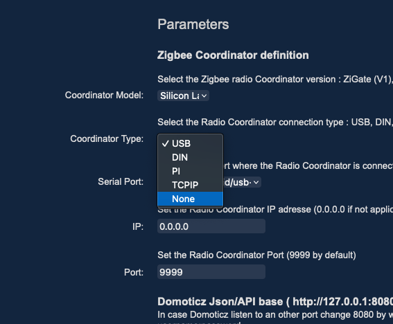

that sound good. You can in all cases check the logs files
- in Domoticz
- in the plugin directory under Log/ folder
eventually you can try to set None in the "Coordinator Type" . It will allow you to get the plugin in a case of testing mode and the WebUI on port 9440 should be working

pipiche wrote: Tuesday 15 November 2022 23:03 that sound good. You can in all cases check the logs files
- in Domoticz
After setting the USB device to none, all error codes in Domoticz log disappeared. At least for a while. After some time it gives me something about coordinator connectivity but I'm sure that's about my lack of USB device.
I do however get "Backend error undefined undefined" when entering the web interface at port 9440. Perhaps that too is about the USB device. I'll just order it and take it from there. From what I understood I can use the Sonoff 3.0 USB with zigbee2mqtt as well if I need to try another plugin.
