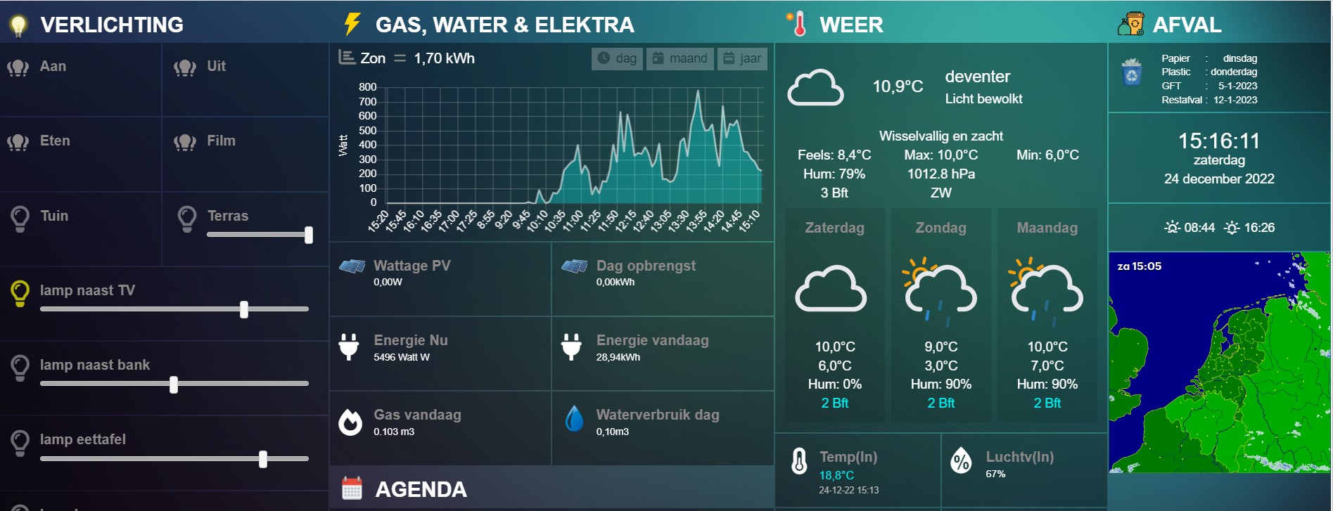

Hello Lokonli, sorry for the late reaction. I have tested the block and it gives the following result.
The tekst part below 'Wisselvallig en zacht' is a little crowded but the rest looks nice

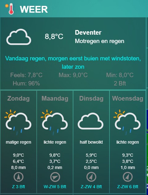

with al little styling it looks a little better.
Is it also possible to make a layout with only the 4 days forecast from knmi, like i use below the KNMI4 block?
- knmi.jpg (59.03 KiB) Viewed 2490 times
Lokonli
- Posts: 2292
Re: KNMI API in Dashticz
Did you already try with layout:0 as block parameter?

I also tested the knmi. It works fine. I found these differences with OWM, while having taken over all the same parameters:
Only 3 day forcast, including today. The forth day gives 0 numbers and a non existing image
The description is not available
Wind force is visible, but not wind direction.
