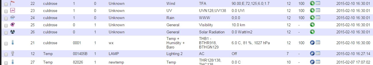

This is what I have and it doesn't work ...
local sensorwu = 'wx' --name of the sensor that gets created when you add the WU device (and that contains multiple values like temperature, humidity, barometer etc)
local idx = 21 --idx of the virtual temperature sensor you created above
if devicechanged[sensorwu] then
	sWeatherTemp, sWeatherHumidity, sWeatherPressure = otherdevices_svalues[sensorwu]:match("([^;]+);([^;]+);([^;]+)")
	sWeatherTemp = tonumber(sWeatherTemp)
	commandArray['newtemp'] = idx .. '|27|' .. tostring(sWeatherTemp)
return commandArray
domo test.jpg (170.74 KiB) Viewed 13889 times

Change
local idx = 21
in the script from 21 to 27 and see if it works.
myozone
Posts: 6
Joined: Monday 19 January 2015 13:03
Re: Scraping only the temperature from WeatherUnderground se
Post by myozone »
Thank you for the prompt reply! changed it - still not working...

Hmmm :(
I don't know, i compared my WU device and virtual sensor device to yours, and look identical.

The only major difference is your line:
commandArray['UpdateDevice'] = idx .. '|0|' .. tostring(sWeatherTemp)
and mine is
ThinkPad

One other thing, I have mine running on a Windows 7 machine. The script is executing though - showing in the log.
