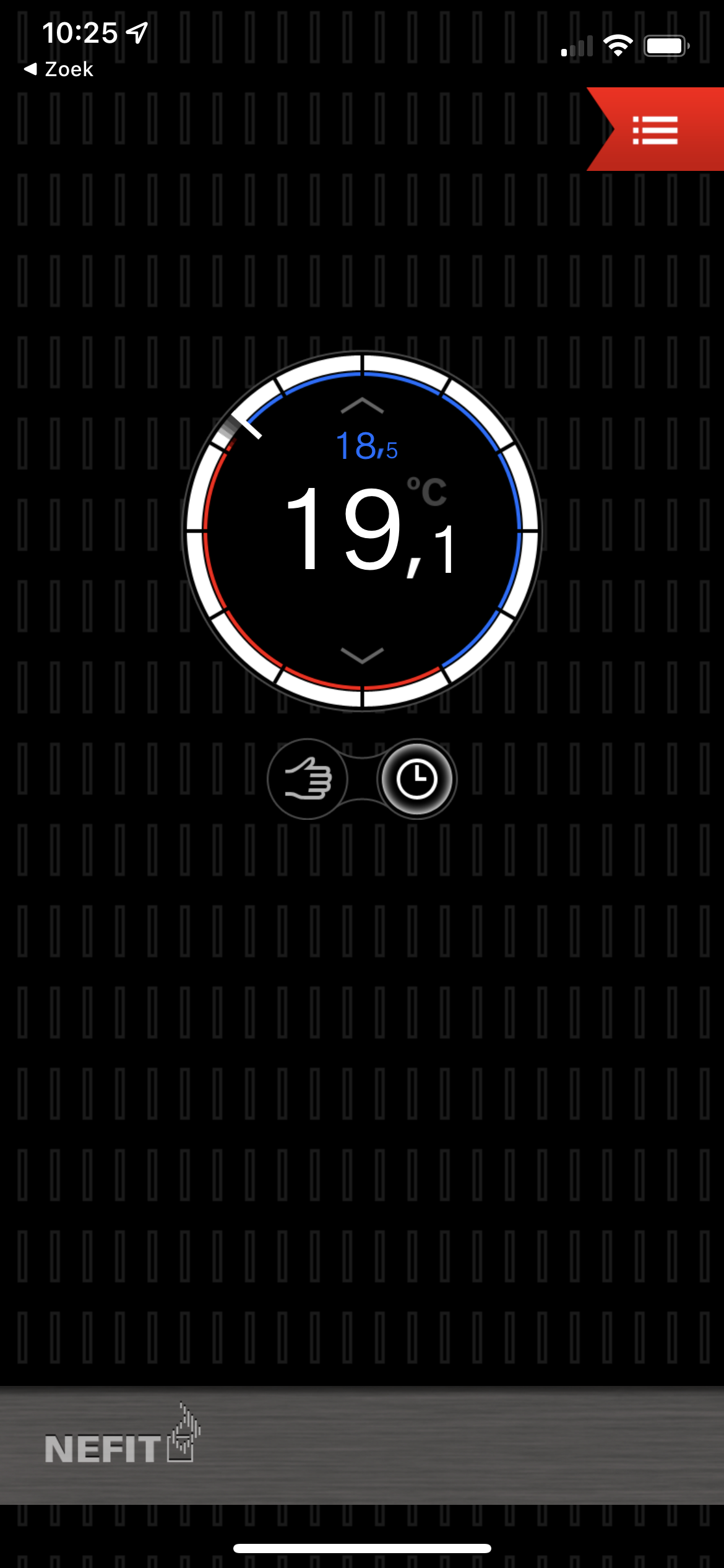

This is what my IOS app shows
https://eye-vision.homeip.net/wp-conten ... G_0593.PNG

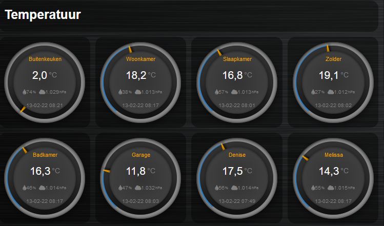

My Temperature sensors (using Xiaomi) are showing correctly as Dial:
https://eye-vision.homeip.net/wp-conten ... ratuur.jpg

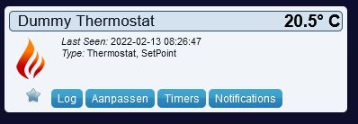

I have then created dummy Thermostat/Setpoint device in Domoticz:
https://eye-vision.homeip.net/wp-conten ... mostat.jpg
This also displays incorrectly in Dashticz (would expect value 20.5 (see above)):
Seems something going wrong with Thermostat/Setpoint dial type with my system. I am using latest beta of Domoticz (2022.1 (build 14182). Domoticz runs on separate Raspberry Pi. I use Dashticz on my Debian Server (10 - Buster). I checked on Windows 11 and MacBook with Firefox and they both show it incorrectly.
