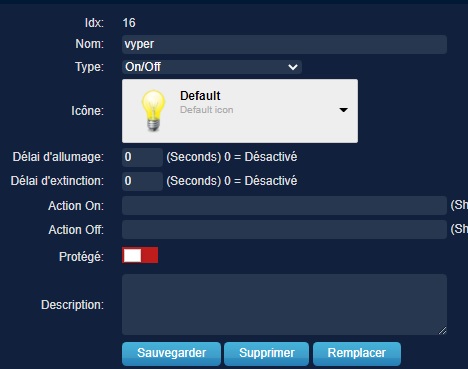

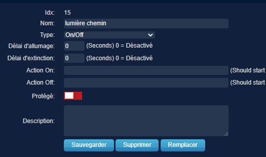

the lamp on off it would be good if we could change the icon because in all the icons for rfy we cannot change the icon I would like to put a portal icon
the version of domoticz is 2021.1
All the buttons on the rfxcom RFXtrx433 range you can´t change(sans titre rfy)
the other image is not rfy but my portal is rfy
