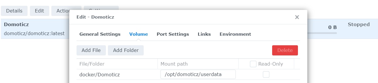

I don't know which one of these two path is the installation path container of Domoticz:

fabry91 wrote: Wednesday 05 January 2022 11:02 i have followed this docker guide: https://registry.hub.docker.com/r/domoticz/domoticz
Did you follow the docker run method or the docker-compose methode
and what is the part that you used in
-v <path for config files>:/opt/domoticz/userdata \
or
    volumes:
      - ./config:/opt/domoticz/userdata
And if you used the compose methode, what path on your Synology is that docker-compose.yaml file

Do you know where your domoticz.db file is placed? normally the scripts and plugin dirs are below that one.
Could be /Volume1/docker/Domoticz

Your script location from within docker is not
/volume1/docker/Domoticz/scripts/relay_ch1_on.sh
but probably
/opt/domoticz/userdata/scripts/relay_ch1_on.sh
you could check that with
docker run -it domoticz/domoticz /bin/bash
ls -al /opt/domoticz/userdata/scripts/
exit docker with just exit.

Then you have a problem with the Domoticz docker installation.
The scripts and plugins directories are not brought outside of docker and cannot be accessed.
Now it depends on the method how you installed Domoticz in docker.
Just to give an idea. My test system (raspberry) runs with this compose file.

So add /volume1/docker/Domoticz/scripts with /opt/domoticz/scripts to the path in the docker GUI on the Synology.
Keep in mind that you have to change the action path in Domoticz too.

AND you should change the path.
Remember: Inside docker path start with /opt/domoticz
Outside docker path start with /volume1/docker/Domoticz

It should be:
script:///opt/domoticz/scripts/relay....
because Domoticz is inside docker and using paths like /opt/domoticz/.....
You could check what the right path is by going inside docker.
