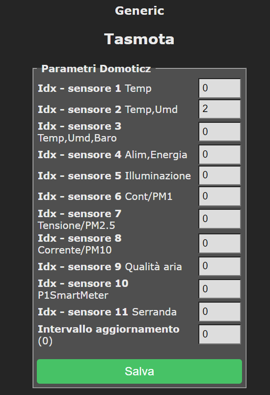

Hi Dave, exacltly... I created two sensor temperature+Umidity (one with IDX 1 and other with ODX2) and I inserted in tasmota "Domoticz" the value 1 in the Sensor Temp-Umidity and 2 in sensor temp-umidity-baro, but I read the temperature only in sensor with IDX1

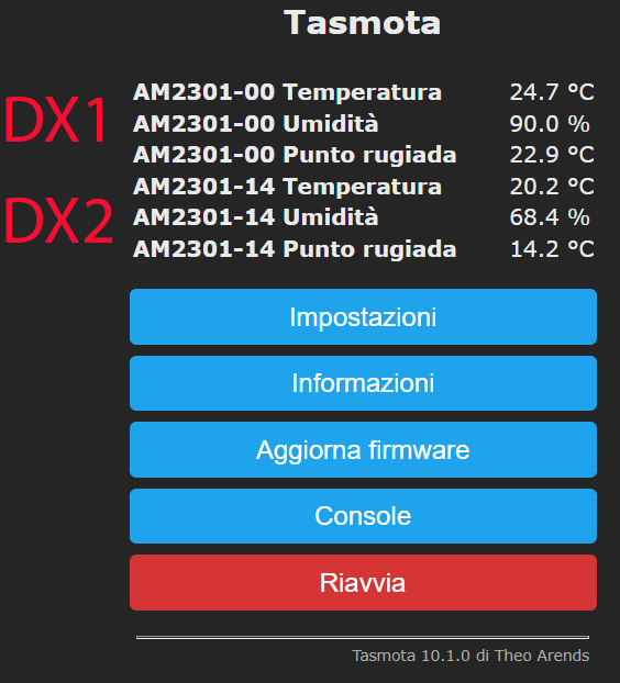

I installed in my PC the MQTT explorer and I checked that the two sensors work ( I read their values in MQTT).
Always in the MQTT Explorere, under the IN string of the Domoticz, I read only in = {"idx":2,"nvalue":0,"svalue":"24.8;88.8;3","Battery":100,"RSSI":5}, I don't found any rifeiment about DX1.
In the attach pic, where I must insert the value of the DX1?
I attach a photo whit the valuues in tasmta web of the two sensor.

I do not have AM 2301 because it is not suitable for the outdoors.
You must use the rules in tasmota. Run console and insert
Rule
  ON tele-AM2301-14#temperature DO var1 %value% ENDON
  ON tele-AM2301-14#humidity DO publish domoticz/in {"idx":2,"svalue":"%var1%;%value%;1"} ENDON
Then turn on the rule
Rule1 1
You can also use the Tasmoticz plug then it should detect two sensors by itself
