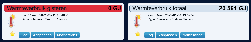

There is a custom sensor that shows the accumulated heat consumption. I would like to add a sensor that shows the heat consumption of the previous day.
heat consumption.png (22.89 KiB) Viewed 683 times
I get stuck making the necessary script.
