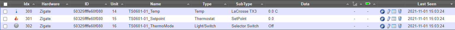

I have updated the plugin to version 5.1.014 but with the same result unfortunately. I think the Tuya device is sending updates (not sure what data it is sending though) but they are not showing in Domoticz (other then the timestamp that is updated):

Can you try to remove All related widgets, and redo the pairing of the device
lostodos
Posts: 35
Joined: Saturday 10 October 2020 1:02
Re: Tuya TS0601 no value from Temperature
Post by lostodos »
That did the trick! I can read the temperature now as well as the setpoint! Nice one:)
