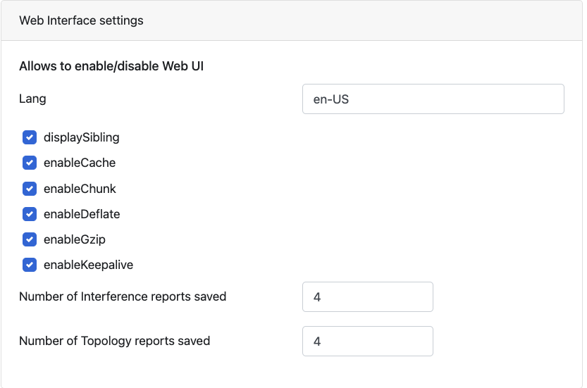

Hey, thnx for answer.
I went into settings and this option was already enabled, see the attached picture. I disabled it, saved config and enabled it again (and again saved config), did another Topology scan - but still the same result

- Posts: 6689
- Domoticz version: 2025.1
Re: Topology report in Zigate plugin
I tried it just now with plugin 5.2.100 and I see the same, no battery nodes and 2 battery nodes floating around. So it seems to be a bug in the dashboard....
