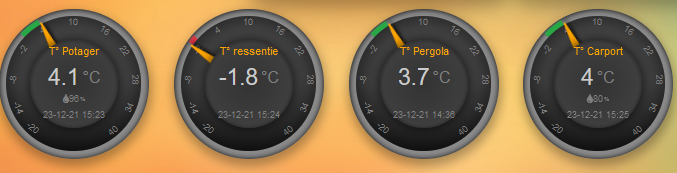

When i do in custom.css :
/*T° Pergola*/
.dial[data-id='temp_hum_256'] .dial .bar.primary {
  border-color: #ff0000;
I have following :
I would like to change the color according to the T ° in custom.js in an afterGetDevices function
I do this in custom.js (with test values) :
function afterGetDevices(){
	var devices = Domoticz.getAllDevices();
	var device256=devices[256];  //Pergola
	var value256 = parseFloat(device256.Data);
	if ((value256>=22) &&  (value256<24)) {
			console.log("value256 : 22-24 : " +value256);
			$('.block_temp_hum_256').addClass('bar_color_jaune');
	else if ((value256>=19) &&  (value256<22)) {
			console.log("value256 : 19-22 : " +value256);
			console.log(device);
			$('.block_temp_hum_256').addClass('bar_color_rouge ');
	else if ((value256>=15) &&  (value256<19)){
			console.log("value256 : 15-19 : " +value256);
			$('.block.temp_hum_256').addClass('bar_color_bleu ');
and this in custom.css
.bar_color_jaune {
		border-color: #ffff00 !important;
.bar_color_rouge {
		border-color: #ff0000 !important;
.bar_color_bleu {
		border-color: #0008ff !important;
But i have this:
an idea ?

Re: Dashticz : border-color dial bar primary
Posted: Friday 10 September 2021 18:06
by Lokonli
A few months ago I've added some functionality to make some customizations a bit easier with the deviceHook function.
Add the following to custom.js:
function deviceHook(device) {
    if (device.idx==256) {
      console.log('hook for device 256');
      var value256=parseFloat(device.Data);
			device.deviceStatus='bar_color_jaune';
			device.deviceStatus='bar_color_rouge';
			device.deviceStatus='bar_color_bleu';
By setting the deviceStatus field of a device, the deviceStatus value is automatically added as CSS class to the block that uses that device.
Then the next tricky part is to find the correct CSS styling. For dials that's not so easy, because the dial block is pretty complex.
If for instance you want to change the colored ring, add the following to custom.css:
.bar_color_rouge .primary, .bar_color_rouge .secondary {
    border-color: red !important
.bar_color_bleu .primary, .bar_color_bleu .secondary {
    border-color: blue !important
.bar_color_jaune .primary, .bar_color_jaune .secondary {
    border-color: yellow !important
Enjoy:)
Posted: Saturday 11 September 2021 8:45
by Doudy
Great :D
Thank you so much.
I could have searched for a long time.
Wonderful.
(For this test I have change the if values)
Posted: Saturday 11 September 2021 10:13
by Lokonli
Nice :)
Posted: Saturday 11 September 2021 11:43
by Doudy
If that can help someone!
Posted: Thursday 23 December 2021 15:29
by Doudy
Since version 3.8.9 the color management is not the same than before!
Posted: Thursday 23 December 2021 22:23
by HansieNL
Have you seen the change in beta 3.8.8?
splitdial
Normally the dial ring color will color from the 0 value to the actual value, which can be positive or negative. Set this parameter to false to start coloring the dial ring from the minimum value, also for a negative minimum value.
Can you add splitdial: false to your dials and see if that fixes your problem?
Posted: Thursday 23 December 2021 23:20
by Lokonli
Doudy wrote: Thursday 23 December 2021 15:29 Hello,
I think the CSS specificity is insufficient. I'll check how fix that.
Posted: Friday 24 December 2021 7:35
by Doudy
Lokonli wrote: Thursday 23 December 2021 23:20 I think the CSS specificity is insufficient. I'll check how fix that.
Posted: Tuesday 28 December 2021 12:20
by Lokonli
Doudy wrote: Friday 24 December 2021 7:35
I've made a little update. If you update to the latest version, then your styling should work if you replace border-color with color:
.bar_color_T35 .primary, .bar_color_T35 .secondary {color: #FF0000 !important;}
You can shorten it by using the following:
.bar_color_T35 .slice {color: #FF0000 !important;}
This will change the ring coloring, independent of primary (above setpoint), secondary (below setpoint), positive, negative labeling.
Posted: Saturday 01 January 2022 9:35
by Doudy
First my best wishes :)
:arrow:
I made a git pull
Then I made the adaptations : .bar_color_T35 .slice {color: #FF0000 !important;} etc...
And the result is correct :
