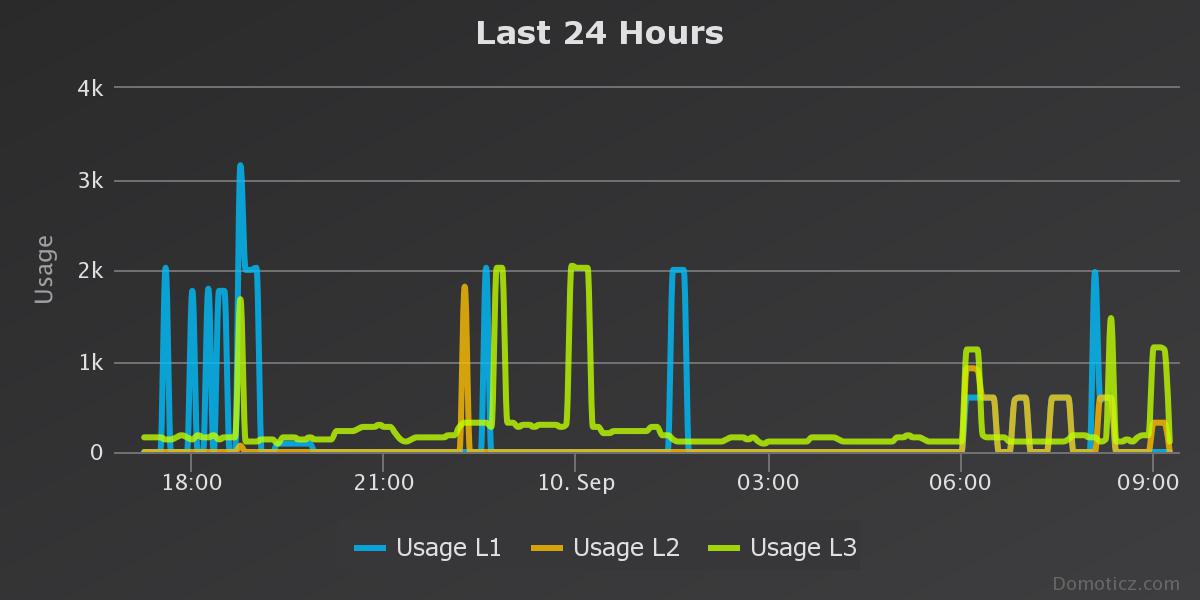

2021-09-10 (1).png (32.32 KiB) Viewed 2282 times

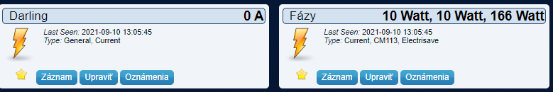

I have one more question.
Can I modify the script to write only positive data?
For example, if 0 is darling so that it does not write it to the database.
Is it possible to create a separate script for DARLING?
