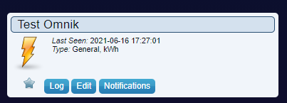

Thanks, I tried different ways but didn't get it. It appears that I'm using another plugin (https://www.domoticz.com/wiki/Omnik_Solar_Inverter). What I've tried:
Create a new virtural device device: General/kWh, changed the python script so the 'idx_E_Total' value is sent to this device. I've ried various configurations (and each of the combinations) of the device
  • Type: Usage
  • Type: Return
  • Energy read: Computed
  • Energy read: From device
I see that the device received the total kWh number:
But the device value is not updated accordingly:
I think Domoticz just receives values like: 9331.2, 9131.3, 9131.4, etc etc. The device should calculate the delta and register this instead of taking the full number.
Any ideas?

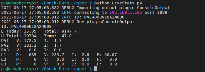

It seems that I need to additionally export the e_today value to Domoticz. Looking at the code of the LiveStats:
import PluginLoader
class ConsoleOutput(PluginLoader.Plugin):
    """Outputs the data from the Omnik inverter to stdout"""
    def process_message(self, msg):
        """Output the information from the inverter to stdout.
        Args:
            msg (InverterMsg.InverterMsg): Message to process
        print "ID: {0}".format(msg.id)
        print "E Today: {0:>5}   Total: {1:<5}".format(msg.e_today, msg.e_total)
        print "H Total: {0:>5}   Temp:  {1:<5}"\
            .format(msg.h_total, msg.temperature)
        print "PV1   V: {0:>5}   I: {1:>4}".format(msg.v_pv(1), msg.i_pv(1))
        print "PV2   V: {0:>5}   I: {1:>4}".format(msg.v_pv(2), msg.i_pv(2))
        print "PV3   V: {0:>5}   I: {1:>4}".format(msg.v_pv(3), msg.i_pv(3))
        print "L1    P: {0:>5}   V: {1:>5}   I: {2:>4}   F: {3:>5}"\
            .format(msg.p_ac(1), msg.v_ac(1), msg.i_ac(1), msg.f_ac(1))
        print "L2    P: {0:>5}   V: {1:>5}   I: {2:>4}   F: {3:>5}"\
            .format(msg.p_ac(2), msg.v_ac(2), msg.i_ac(2), msg.f_ac(2))
        print "L3    P: {0:>5}   V: {1:>5}   I: {2:>4}   F: {3:>5}"\
            .format(msg.p_ac(3), msg.v_ac(3), msg.i_ac(3), msg.f_ac(3))
I've tried to add the e_today to the code, without any knowledge of Python and it seems that I missed something. I've added to the config.cfg file the line: 'idx_E_Today = 315 #nieuw'

import PluginLoader
import urllib
import urllib2
import ConfigParser
config = ConfigParser.RawConfigParser()
#change to correct folder.
config.read(['/home/pi/Omnik-Data-Logger/config-default.cfg', '/home/pi/Omnik-Data-Logger/config.cfg'])
domoticz_host    = config.get('domoticz','domoticz_host')
domoticz_port    = config.get('domoticz','domoticz_port')
domoticz_url     = config.get('domoticz','domoticz_url')
idx_Temp = config.get('domoticz','idx_Temp')
idx_PV1_U = config.get('domoticz','idx_PV1_U')
idx_PV2_U = config.get('domoticz','idx_PV2_U')
idx_PV1_A = config.get('domoticz','idx_PV1_A')
idx_PV2_A = config.get('domoticz','idx_PV2_A')
idx_AC_Output = config.get('domoticz','idx_AC_Output')
idx_E_Total = config.get('domoticz','idx_E_Total')
idx_E_Today = config.get('domoticz','idx_E_Today') #nieuw
idx_E_Current = config.get('domoticz','idx_E_Current')
url = ("http://" + domoticz_host + ":" + domoticz_port + "/" + domoticz_url)

I have a General/custom sensor IDX 315 to which I try to export the data. This sensor is similar configured as the sensor that consumes the e_total (which part of the code I've tried to copy).
Any ideas what I missed?
