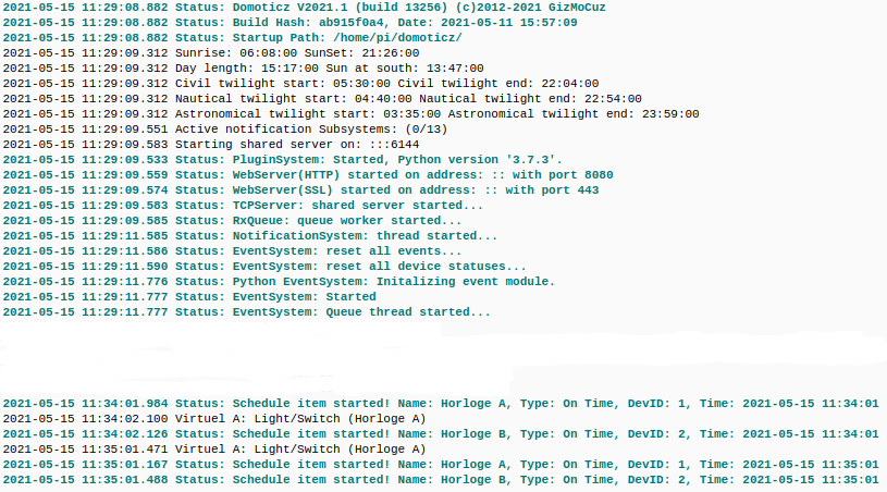

In running DomoticZ on latest stable 2021.1. Since this version, we have the opportunity to set the loglevel par hardware device. This is awesome.
I use dummy devices with a planning and each time the device change, I have a line in the log :
2021-05-15 11:31:01.596 Status: Schedule item started! Name: Horloge A, Type: On Time, DevID: 1, Time: 2021-05-15 11:31:01
I disabled all the log (info, status et error) for the corresponding Dummy hardware, but I still have the status line.
I tried on a new DomoticZ installation (with beta last update Domoticz V2021.1 build 13256).
This is my configuration :
  • 2 dummy hardwares : Dummy A with all loglevel set ON and Dummy B with all loglevel set OFF.
  • 2 virtual devices Horloge A crated from Dummy A and Horloge B crated from Dummy B with exactly the same planing
I expected not to have any log for Horloge B. This is what I got :
Sans titre.png (127.13 KiB) Viewed 708 times
The info log of Horloge B is not showed, that's good, but I still got the status log for Horloge B.
Is it a bug or is there a configuration to turn it off ?

keros wrote: Saturday 15 May 2021 11:48 The info log of Horloge B is not showed, that's good, but I still got the status log for Horloge B.
The Status Schedule message you see does not come from the Hardware but from the Scheduler. You cannot prevent individual status messages from this domoticz subsystem but you can prevent all status messages to the log by modifying /etc/init.d/domoticz.sh by editing this file
Change line
DAEMON_ARGS="$DAEMON_ARGS -loglevel  normal,status,error"
to
DAEMON_ARGS="$DAEMON_ARGS -loglevel  error"
This will prevent status or normal messages to show up in the domoticz log.
