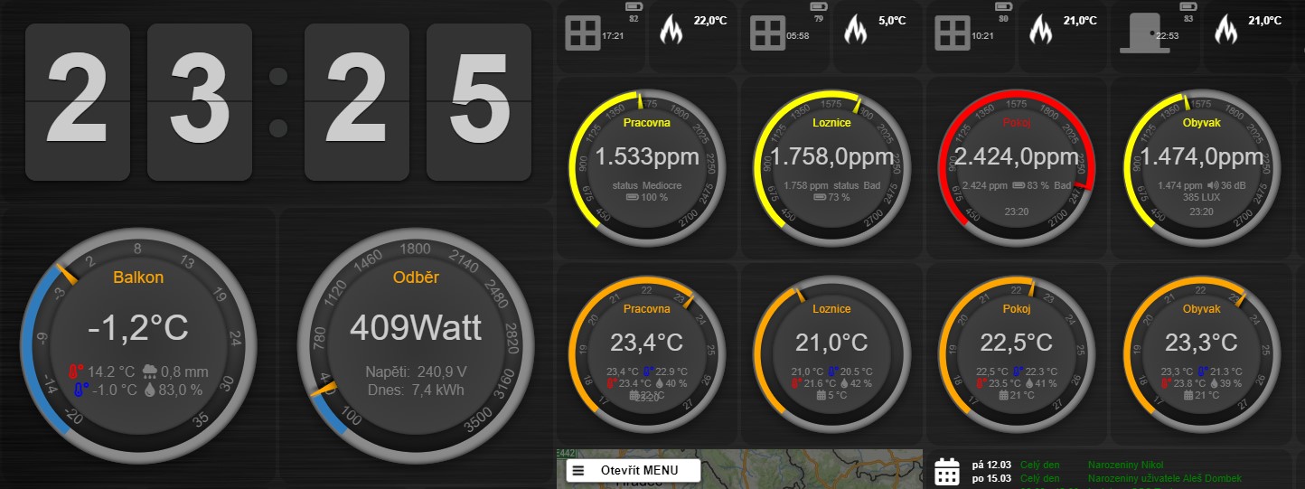

NIce, but most of the ikons extend size.. :-)
So change something in css.? or?
Snímek obrazovky 2021-03-12 200203.jpg (196.78 KiB) Viewed 1861 times

Krenstik wrote: Friday 12 March 2021 20:02 NIce, but most of the ikons extend size.. :-)
I made indeed quite some changes to the css files.
I'll check what creates bigger icons.

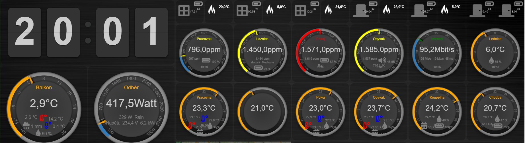

NOw I have to clean values, to have not a double value.
Snímek obrazovky 2021-03-12 232553.jpg (161.91 KiB) Viewed 1831 times

I made some small styling changes. Please pull latest beta version. (the unit behind the main value will become a bit smaller)

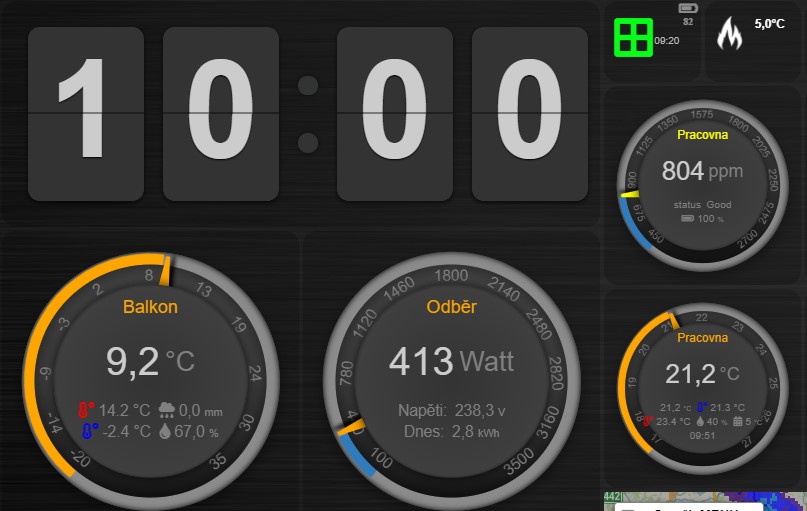

two questions:
How I can get two (three) lines on dial? Always two lines? Like in dial "odber /409 Watt" In the case of the dial " Pracovna" with CO2 (ppm), if the text is shorter, It mixes it two status.
Can I add spares between value and unit in dial " Odber"? (277Watt)
Thank you.
Snímek obrazovky 2021-03-13 032531.jpg (94.86 KiB) Viewed 1813 times

Krenstik wrote: Saturday 13 March 2021 3:32
Add the following to the item definition in the values part, to give the item the full width:
  addClass: 'w100'
I've increased the left margin of the unit a little bit in latest beta. Sufficient?

Lines - much better, great.
I do not see a big change, but I can say enough.
Is any way how to put in dial sunrise and sunset?
and also, manual for non-programming guys, how to change the color of status for example of ppm in my case? Or any kind of value in dials?
Thank you.
{ value: 'Quality',label:'status', type: 'text', idx: 43 ,addClass: 'w100'      },
Snímek obrazovky 2021-03-13 100020.jpg (74.28 KiB) Viewed 1785 times

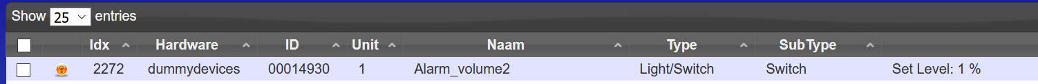

I got a little issue.
I use a dimmer switch to manage the volume of my alarm (devices), off, on with volume x-y.
I made a dial for this switch.
When i turn the volume to 0 (i use zero for off) then domoticz gives a value 1 (so not off in my case)
blocks['volume']	= {
	title: 'Volume',
	idx:	2272,
	values:	[
		idx: 2272,
		decimals: 0,
		setpoint: 60,
		isSetpoint: true
	layout: 1,
	type: 'dial',
        color: 'white',
	width: 3,
//	icon: '',
	hide_data: false,
	switch: false,
        min: 0,
        max: 100,
        showring: true,
        showunit: true,
	decimals: 0,
	animation: true,
//	fixed: true,
        shownumbers: true,
        last_update: true}
There are a few steps:
1) Add the right device status
You can use the recently added device hook functionality. You have to do some programming...
Add the following to custom.js:
function deviceHook(device) {
    if (device.idx==43) {  //Check that device 43 is indeed the correct Domoticz device id
        var ppmvalue = parseFloat(device.Data);
        device.deviceStatus = ppmvalue> 500 ? 'bad':'good';
In this example the deviceStatus will be labeled 'bad' or 'good', depending on the ppm value.
The deviceStatus will be added as CSS class name to the dial values that use this device.
2) Set the styling in custom.css
.item.bad {
  color: 'red' !important
.item.good {
   color: 'green' !important
Lokonli

pvklink wrote: Monday 15 March 2021 18:33 I got a little issue.
	title: 'Volume',
	idx:	2272,
	values:	[
		idx: 2272,
		decimals: 0,
		setpoint: 60,
		isSetpoint: true
	layout: 1,
	type: 'dial',
        color: 'white',
	width: 3,
//	icon: '',
	hide_data: false,
	switch: false,
        min: 0,
        max: 100,
        showring: true,
        showunit: true,
	decimals: 0,
	animation: true,
//	fixed: true,
        shownumbers: true,
        last_update: true}
Should work better now. Can you test latest beta?

pvklink
Posts: 822
Joined: Wednesday 12 November 2014 15:01
Domoticz version: latest b
Re: Dashticz v3.7.6 beta
Post by pvklink »
lokonli is great... :-)
Problem solved and you also solved a problem i wanted to adress after this:
- when you change a value in domoticz, this dashticz dial does not refresh, this also solved :-)
for me last questions are:
0. how do i get rid of "0 level" in the dial , see attachment.
hide_data: true, does not help
@update: solved, by removing the values part and add isSetpoint: true in the main part of the block
1. what does "fixed" do?
2. In my case do i have to repeat idx 2272 in the main part as well as in the values part
@update: solved, values part removed
3. Does setpoint: 60 has any use ? i thougt you could influence the colors of the ring when below or above this point
4. what does layout do
My current volume(dimmer) dial
	title: 'Volume',
	idx:	2272,
	values:	[
		idx: 2272,
		decimals: 0,
		setpoint: 60,
		isSetpoint: true
	layout: 1,
	type: 'dial',
        color: 'white',
	width: 3,
//	icon: '',
	hide_data: true,
	switch: false,
        min:0,
        max:100,
        showring: true,
        showunit: true,
	decimals: 0,
	animation: true,
//	fixed: true,
        shownumbers: true,
        last_update: false}
