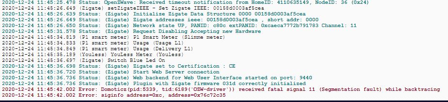

After having installed the Zigate plugin on my Syno DS215+ and restarting Domoticz, everything works fine.
However, when I add the hardware (Zigate USB) the web UI of Domoticz is not accesible anymore ("hangs") but Domoticz runs when I inspect the package center.
I managed to catch this from the log:
Zigate plugin Error on Synology: fatal signal 11
- zigate error.JPG (70.6 KiB) Viewed 552 times
Re: Zigate plugin Error on Synology: fatal signal 11
That is a known issue on syno, please do edit the file
Conf/PluginConf-xx.json where xx is the HardwareID in Domoticz
and add the following line in that file (please do keep the syntax correct in the file, so I suggest that you put it in the middle of the file)

"internetAccess": 0,-
Thnx for your quick reply pipiche, did read your suggestion already, but it did not solve the problem.
When I delete the Zigate folder, Domoticz works fine again.
But that soes not solve the problem of course. Any other suggestions?
Please provide the full log when starting the plugin
Please provide the file PluginConf-xx.json
Just installed the plugin again, (this time not via putty and "sudo git clone ...." command, but just copying the folder with Winscp).
Added the hardware again and guess what: it works!
Don't know if the different installation method did the trick?
Maybe some access right issues
