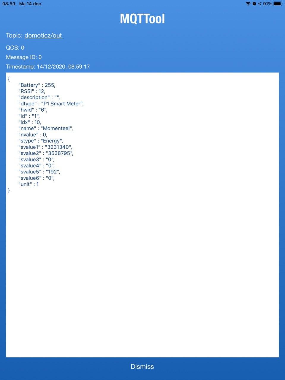

When I look at the MQTT traffic by using my MQTT tool I see strange messages coming from the smart-meter plugin.
Please have a look at the 2 attachements.
The come in groups of 4 around every 5 seconds.
can someone tell me the cause of this and is this normal behaviour?
- header
- sm-2.jpg (56.59 KiB) Viewed 1333 times
- payload
- sm-1.jpg (61.96 KiB) Viewed 1333 times

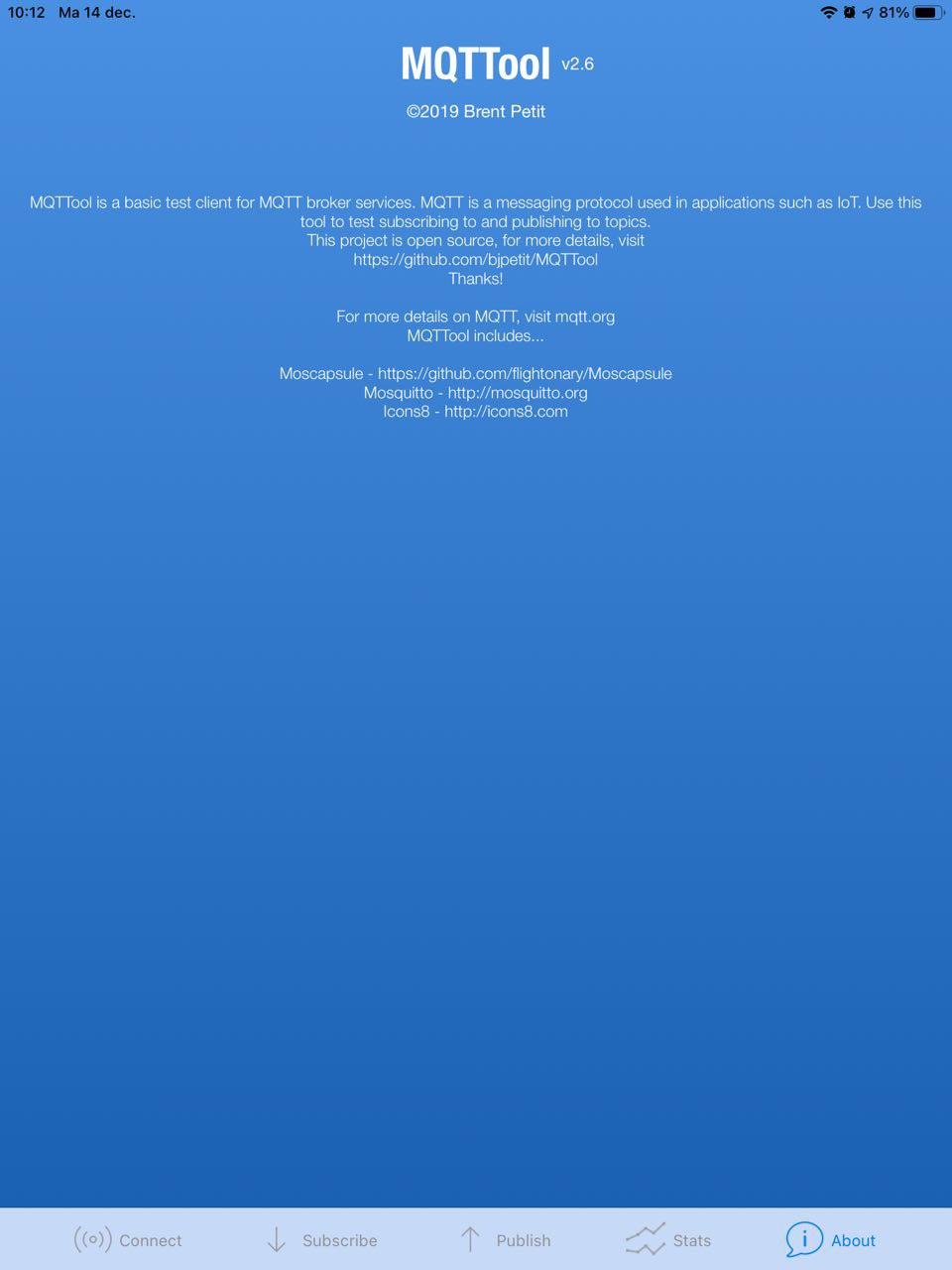

I use the MQTTool on my iPad. See attachement.
And the MQTT traffic log is in the attachements as well.
- MQTTool.jpg (49.42 KiB) Viewed 1322 times

looks like domoticz is sending confirmations of the P1 signals thru MQTT using domoticz/out

According to this post you also started the MQTT hardware module. That would explain the MQTT message to domoticz/out but not the funny ones with only "{"
These are not send by domoticz.

Because the real MQTT messages to domoticz/out for the P1 device are send when the P1 device is updated and this device gets updated via the P1 hardware module. The funny ones seem to be a kind of echo created by something else then domoticz.
If you want to convince yourself and your are not convinced by the mosquitto_sub command I posted earlier then install a network sniffer tool and monitor the network for port 1883
