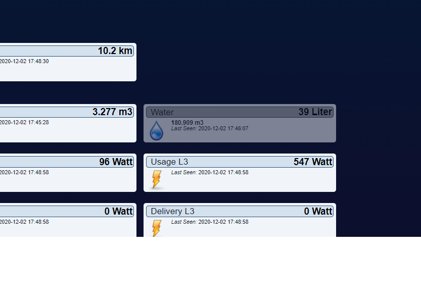

Just noticed something I've never seen before, a dark/grayish UI entry for one of my sensors:
Any idea what causes it?

Just noticed today; one of the sensors being greyed out:
It is working; didn't see it before. What could this be?

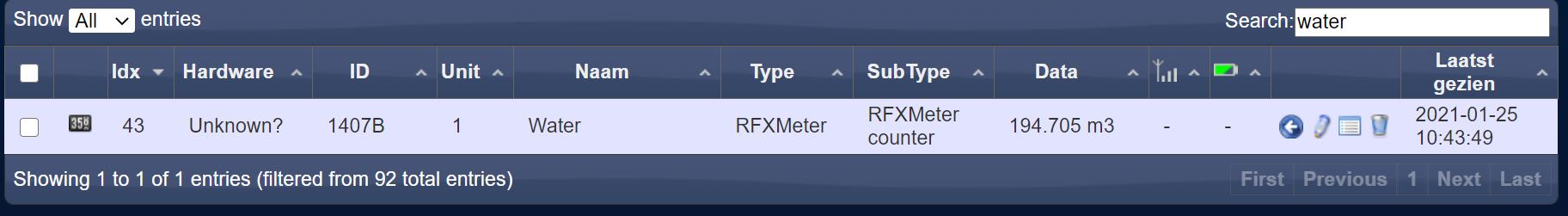

Hmm... Strange... I recall it's always been the same, just not greyed out:
2021-01-25 10_52_48-Window.png (68.24 KiB) Viewed 2612 times
I dont think i ever had any hardware attached... And it is working as it should...
Very weird...
Re: Grayed-out UI item in Utility Sensors
MikeyMan wrote: Monday 25 January 2021 10:53 I dont think i ever had any hardware attached... And it is working as it should...
It should not be possible to create a device without a 'parent' hardware without entering it directly in the database using an external program.
Also: devices are removed from the system when the 'parent' hardware is deleted in domoticz.
I can only guess what's happened but assume that some time in the past the hardware that this device was connected to was removed with an external program or something else in the database happened causing the connection between your device and the 'parent' to got lost.
I don't see any direct issue for the state of the system other then the greyed out tile but to be sure I would reconnect it to one of your hardware objects.

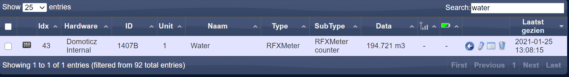

MikeyMan
Posts: 237
Joined: Wednesday 17 October 2018 12:11
Post by MikeyMan »
That fixed it! :)
2021-01-25 15_35_01-Window.png (67.36 KiB) Viewed 2584 times
Is that a reserved hardware ID? The internal one?
Thanks :)
