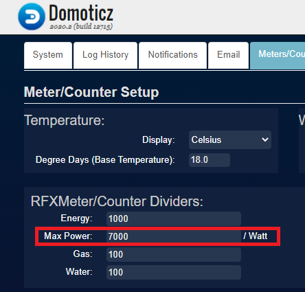

Found it... It's in the settings for Domoticz under Meters/Tellers, labeled "Max Power".
Re: "Power usage to high" Error logged by P1 and Enphase hardware
rrozema wrote: Monday 23 November 2020 15:28 Found it... It's in the settings for Domoticz under Meters/Tellers, labeled "Max Power".

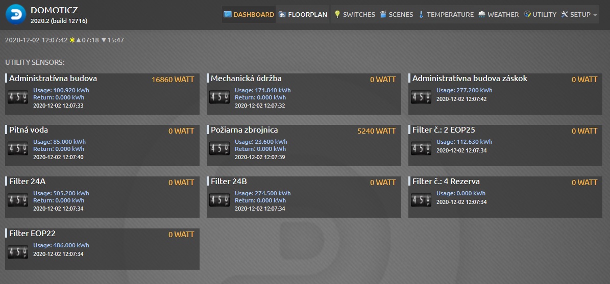

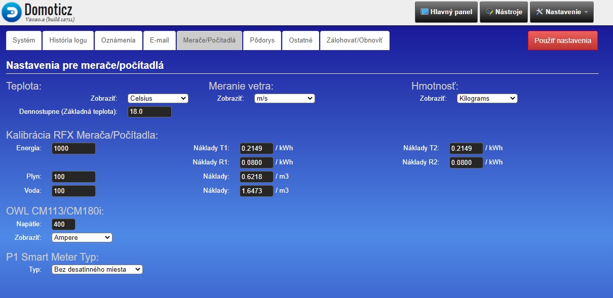

I greet but I did not find such a possibility
Bez názvu.jpg (129.76 KiB) Viewed 3688 times
fricosk wrote: Wednesday 02 December 2020 8:53 I greet but I did not find such a possibility
Please try again after clearing browsercache / appcache (different things)

And how do I do it? as a lama

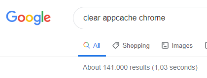

fricosk wrote: Wednesday 02 December 2020 9:09 And how do I do it?
browser cache.png (10.47 KiB) Viewed 3669 times

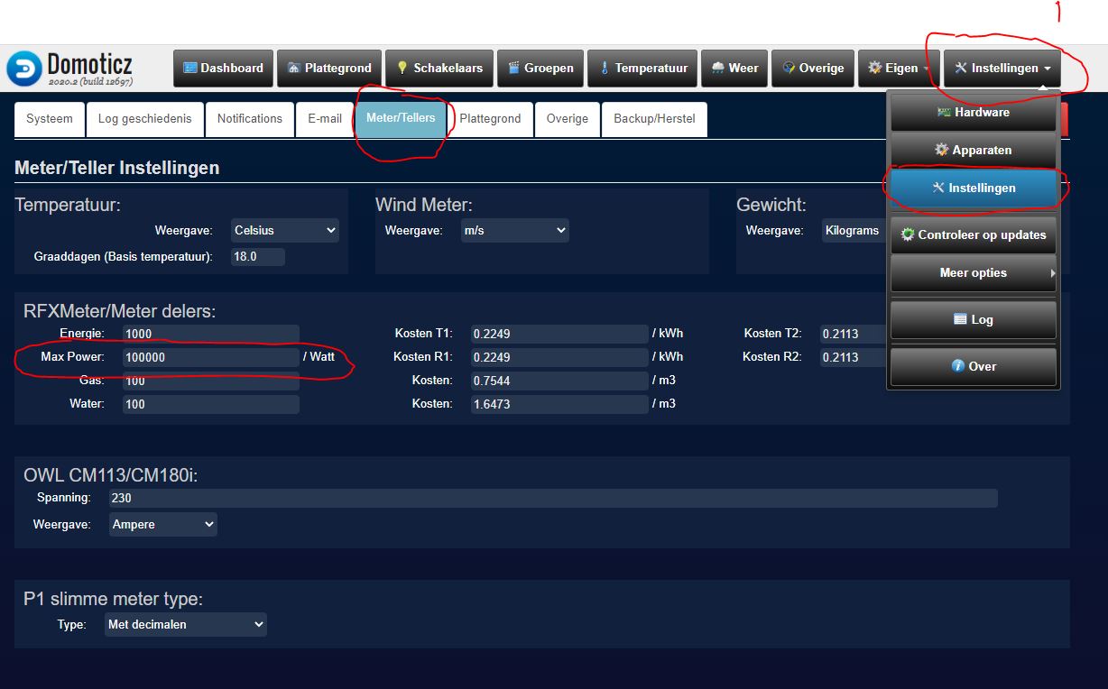

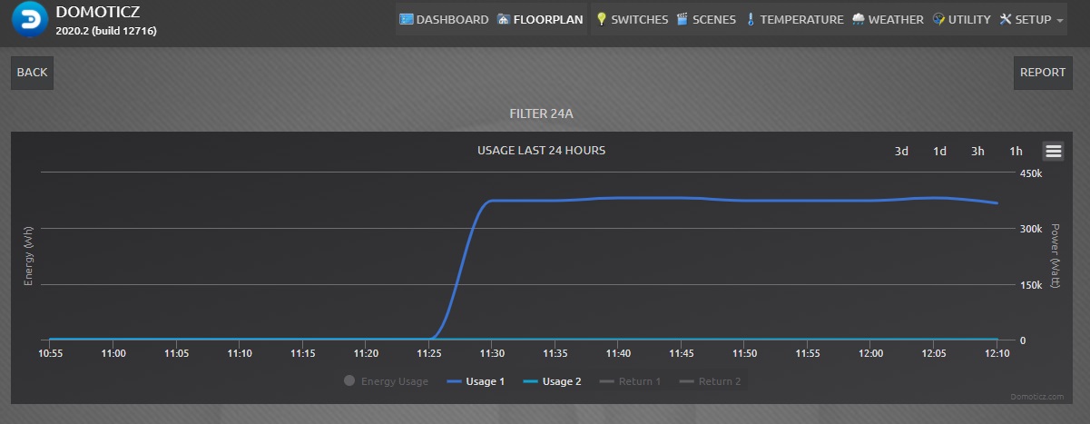

Thank you helped until restart domoticz. ;)
I don't know if the problem has already been solved, it doesn't show performance values ​​but the subscription there is is graphing.
If I'm on the wrong topic please relocate.

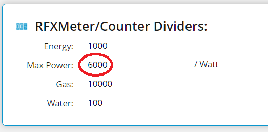

waaren wrote: Monday 23 November 2020 15:53
Recent changes in beta can be found / identified on this wiki page
I am also seeing this messages in log in recent beta's
2020-12-06 11:10:08.875 Error: P1 Meter: Power usage to high! Usage: 6066 Watt. Max Usage configured: 6000. (NodeID: 0x0000, ChildID: 0x0001, SID: Usage L1)
2020-12-06 11:10:38.874 Error: P1 Meter: Power usage to high! Usage: 6044 Watt. Max Usage configured: 6000. (NodeID: 0x0000, ChildID: 0x0001, SID: Usage L1)
2020-12-06 11:12:38.869 Error: P1 Meter: Power usage to high! Usage: 6387 Watt. Max Usage configured: 6000. (NodeID: 0x0000, ChildID: 0x0001, SID: Usage L1)
Version: 2020.2 (build 12716)
Build Hash: ee672d111
Compile Date: 2020-12-02 08:53:23
In settings i have set Max Power: 8100 as this reflects my mains fuse 35A at 230V.
I will perform some further testing today, washing & drying & cooking & heating together.
