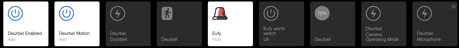

Well I see all the devices:
I can create an automation in Apple Home to turn on the light when motion is detected. I receive a notification from the home app when the doorbell is pressed. But I can't figure out how to have that doorbell press in domoticz.

Guess there's some miscommunication here. Homebridge <> Domoticz is operational. I can switch lights with siri and with the Home app from Apple. Hince, it's there that I made the automation to switch on the front light when motion is detected at the doorbell camera. It's just the doorbell that I can't seem to do anything with.
