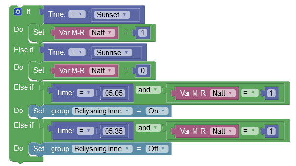

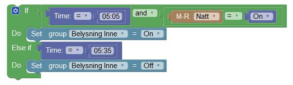

Hi, i am complety novise on this script thing and i have start to setup Domoticz on a Raspberry with some switches and have try this scripts and its seems to work but is it correct?
First i found this example and i created a virtual switch if its night or not
Then i want to start lightgroup at time 05:05 but only if there is night, then i want to switch of at 05:35 so i create this:
Is this correct way to do this?
My first blockly script

What also is possible is switching 'Natt' with a timer in the switch itself. I found out that this is working more reliable.

I think this will do the job after making a variabele called 'Natt'

Ok i do a test whitout the virtual switch and use variable instead, thanks for help so far

With use of a variable you can’t accidentally press the button.
There will be only a problem when Sunrise time is between 05:05 and 05:35. But you have a few months to find a solution for that.
For example: if Time is > 05:05 and < 05:35
