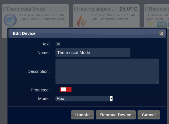

I try to figure out what's going on. I create config file for this device on openzwave. On the zwave console everything is working as expected. But on domoticz I have some issues.
First, I can't change the mode of the thermostat. You can check the utility page I have :
thermostat mode
thermostat mode
I can only change the mode by editing manually like :
thermostat mode edit

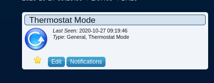

Second, I can't see the stat of the thermostat on normal mode. See image bellow :
thermostat stat
thermostat stat
But I see it on the device list.
