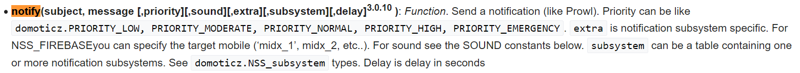

Varazir wrote: Wednesday 23 September 2020 21:57 Strange as this command works just fine
dz.notify("Aktuell grupp",control[selectedGroupNumber],dz.PRIORITY_NORMAL,dz.NSS_HTTP)
It might look like its OK but what you send is
subject:"Aktuell grupp"
message:control[selectedGroupNumber]
priority: dz.PRIORITY_NORMAL
sound: dz.NSS_HTTP -- ignored for all subsystems except pushover
extra: nil -- ignored
subsystem: nil -- send to all configured subsystems
And for the notify in you helper
dz.notify(message,dz.PRIORITY_NORMAL,dz.NSS_HTTP)
subject:message
message:dz.PRIORITY_NORMAL -- a number
priority: dz.NSS_HTTP -- a string
sound: nil -- ignored for all subsystems except pushover

I misread the wiki, is there a way to only send a subject or a message ?
just add a extra , ?
Raspberry PI 4 with RaZberry Controller 2016 ZWave+ and CC2531(zigbee)
Several IKEA devices/z-wave devices
Re: Custom http nonfiction
Varazir wrote: Thursday 24 September 2020 18:52 I misread the wiki, is there a way to only send a subject or a message ?
Subject is the only required parameter. All other ones can be nil (implicit or explcit)
so
domoticz.notify('subject') -- OK will send message to all configured subsystems
domoticz.notify('subject',nil,nil,nil,nil,dz.NSS_PUSHOVER) -- OK will send message to Pushover
domoticz.notify('subject',,,,,dz.NSS_PUSHOVER) -- NOT OK (lua does not recognize ,,)
