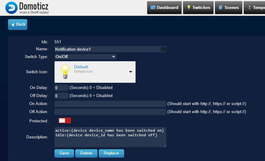

Could look like below
        script to send adjustable notifications
        Enter text in description field like below 2 lines
        Text within {} can be changed. device_name and device_id will be substituted by script
        active:{device device_name has been switched on}
        idle:{device device_id has been switched off}
return

Larsoss wrote: Wednesday 23 September 2020 0:09 Almost Waaren, still no meassage to telegram.. but you get the point of what i was searching for.
I tested the script before posting and it works for me. Did you add the required text in the description field for the devices at hand?
Do you see any messages in the log?

Re: Notification script
Larsoss wrote: Wednesday 23 September 2020 11:44 I really don't understand sorry .. and I also understand that you don't want to deliver everything in ready-made solutions .. but I really don't see what I'm forgetting .. I've tried to put text in everything, but stay now you get the message Text not found in description 'in the log.
Did you enter the exact text in the description field of the device like below? (Click on the edit button of the device in the switches tab to get to this screen)

Re: Notification script  [Solved]
Post by Larsoss »
waaren wrote: Wednesday 23 September 2020 12:03
No i did not, now i have done it. and the telegram arive's.. thank you very much.

waaren wrote: Tuesday 13 October 2020 13:59
Larsoss wrote: Tuesday 13 October 2020 13:06 Can I also process it in this script? So if a new season starts (winter for example) that there will also be a message about it?
But why not combine these functionalities into one script. (after restoring level 0 "Off")
        script to set selector switch to season and
        send notifications of levelNames of selector type switches
local time = '08:30'
local spring = '21/03'
local summer = '21/06'
local autumn = '21/09'
local winter = '21/12'
local seasonDevice = 668
return
    on =
        timer =
            'at ' .. time .. ' on ' .. spring,
            'at ' .. time .. ' on ' .. summer,
            'at ' .. time .. ' on ' .. autumn,
            'at ' .. time .. ' on ' .. winter,
        devices =
            seasonDevice,  -- You can add other selector type devices you want to check
    logging =
        level = domoticz.LOG_DEBUG,
        marker = 'Season selector notifyer',
    data =
        devices =
            initial = {},
    execute = function(dz, item)
        local season = dz.devices(seasonDevice)
        local function procesNotification( label )
            if dz.data.devices[item.id] ~= label then
                dz.data.devices[item.id] = label
                return label
                dz.log('procesNotification: Label did not change', dz.LOG_DEBUG)
        --main
        if item.isTimer then
            if item.trigger:find(winter) then season.switchSelector('Winter')
            elseif item.trigger:find(spring) then season.switchSelector('Spring')
            elseif item.trigger:find(summer) then season.switchSelector('Summer')
            elseif item.trigger:find(autumn) then season.switchSelector('Autumn')
                season.switchSelector('Very strange season')
            local msg = procesNotification(item.levelName)
            if msg then
                dz.log(msg, dz.LOG_DEBUG)
                dz.notify('notifyer','Selector ' .. item.name .. ' switched to ' .. msg, dz.PRIORITY_NORMAL,nil,nil,dz.NSS_TELEGRAM)
Yep, this works right away. Thank you. And I haven't recovered anything.
The dummy is as above
Raspberry 4 - USB boot Domoticz /|\ Raspberry 2B - Dashticz /|\ Tasmota device's /|\ Philips Hue & Yeelight
