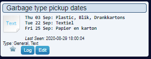

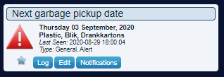

I have two types of garbage collection "plastic" and "restgft" occurring on the same date, once every two weeks, but every week "restgft"
The devices:
Garbage collection pickup dates.PNG (9.65 KiB) Viewed 2289 times
Next garbage pickup date.PNG (8.04 KiB) Viewed 2289 times
Ofcourse the Alert device lists only one, but text device should list two pickups on 2020-09-03 and on 2020-09-17.
I have the impression that the current script cannot handle two pick-up type on the same date. Am I correct?

plugge
Re: dzVents Garbage pick-up alternating dates two pick-ups
Post by plugge »
waaren wrote: Wednesday 30 September 2020 11:53 New version because http ://json.mijnafvalwijzer.nl/ - only accepts calls from paying customers.
Thanks waaren, works like a charm!
And good learning material for scraping in dzVents.
