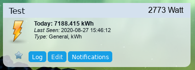

2. After you have created your virtual sensor, like
Screenshot_Electric Counter1.png (37.78 KiB) Viewed 1923 times

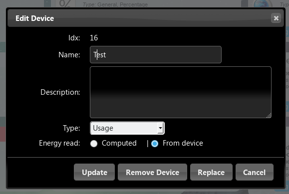

you should "Edit" the device.
If your device sends the accumulated consumption, you have to set "Energy read" to "From device".
Screenshot_Electric Counter2.png (31.16 KiB) Viewed 1923 times

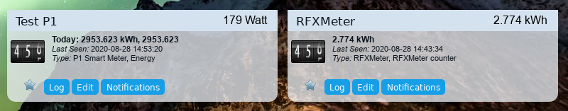

I'm trying to use a RFXMeter counter (device type = 113, subtype = 0) to show the daily energy production and the total energy produced by my solar installation. I'm sending the next message to mqtt topic domoticz/in:
{"type":"command","param":"udevice","idx":765,"nvalue":0,"svalue":"2772;7188405"}
and all I can get is, in this case, 2,772 kWh in the top right corner of the device box, and same quantity as total accumulated.
If I send another message later, with a new instant production in Watts and a current total energy produced (kWh), the new instant production is shown either in top right corner as in the middle of the device box.
I created a virtual device, exactly the way you did with a JSON call.
Tested it, and I noticed exactly the same behavior, as you described. It is according the Wiki: https://www.domoticz.com/wiki/Domoticz_ ... counter.29 and also: https://piandmore.wordpress.com/2019/02 ... -domoticz/
It is sufficient to send only the first value (2772). The second value (7188405) has no effect and is not used. You have already noticed that.
I think you have to use another device as a counter, which has been set to "Energy".
Perhaps P1 Smart meter?
Screenshot_RFX meter.png (131.65 KiB) Viewed 1863 times
However I have not figured out how to create a P1 Smart meter device with a JSON call.
