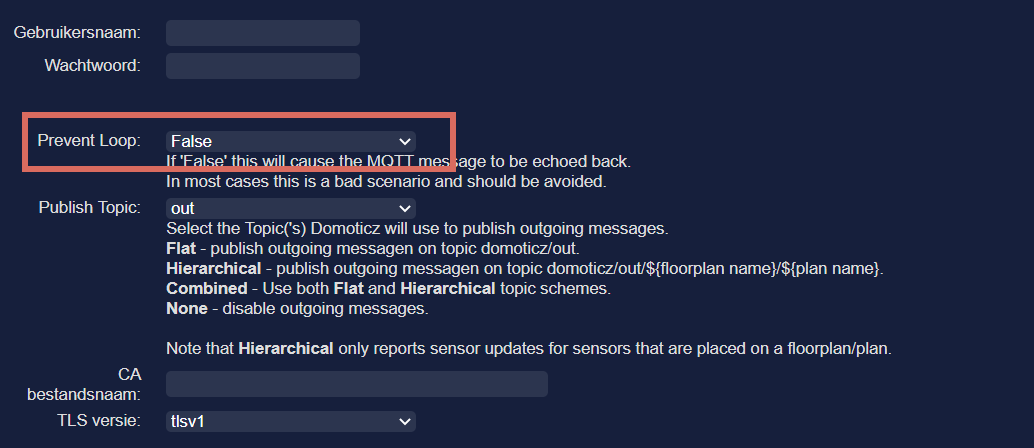

I figured it out by myself. In DOMOTICZ | HARDWARE I edited my MQTT GATEWAY
I set the 'Prevent Loop' from TRUE to FALSE (see attachment) and now it reacts on the first command

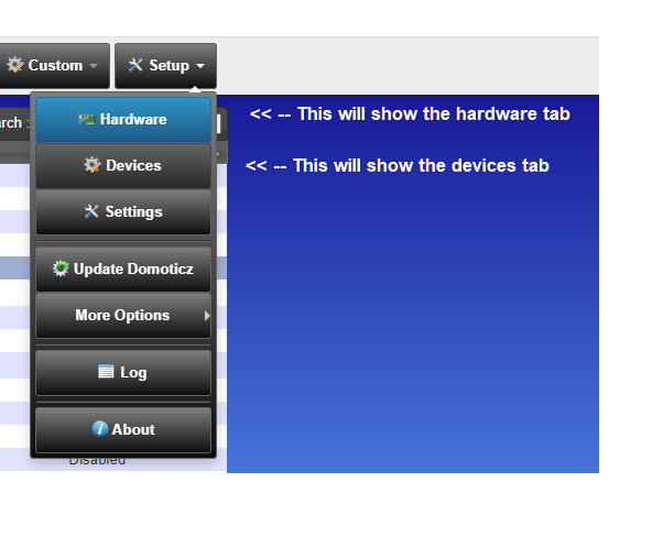

pedemo wrote: Wednesday 26 August 2020 11:55 I don't know where to find it (maybe you can put it here in Dutch because I'm using it in Dutch
Just switch to English for a moment
Setup pulldown.png (39.21 KiB) Viewed 1221 times

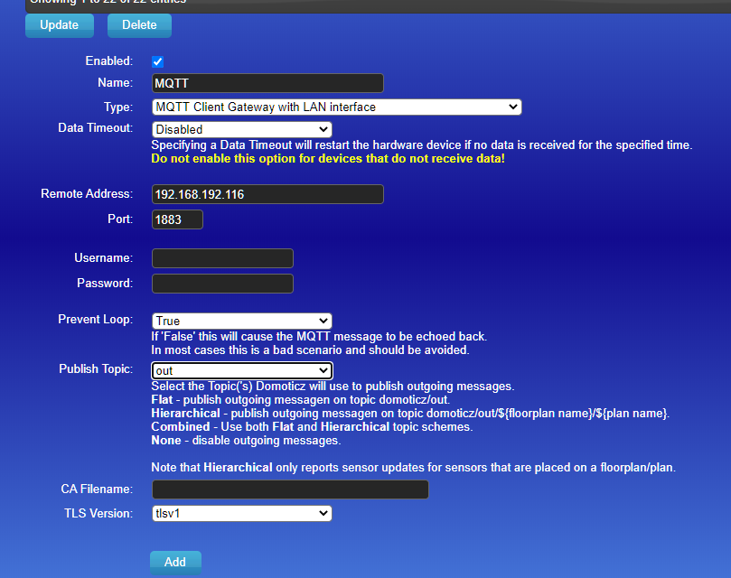

* I install it with sudo apt install mosquitto
this is not describing /showing how you configured MQTT in domoticz.
I mean this page
