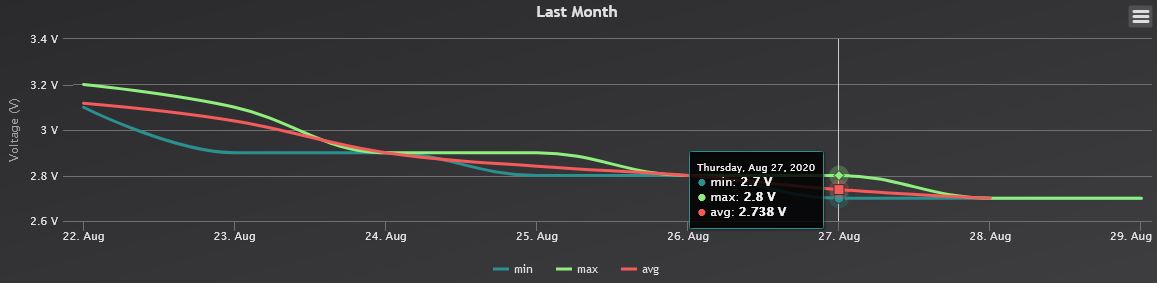

Well I moved one of my TS0201 sensors to my other test network that uses the CC2531 as a coordinator etc and that made no difference, as you can see from the attachment. Looks like I won't be using these for too much longer at this battery usage rate
