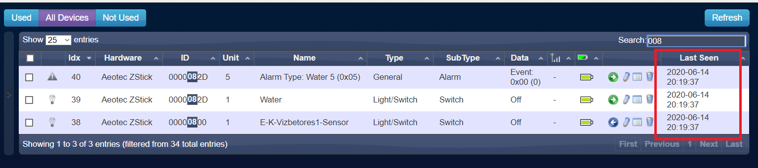

Please help me solve my problem!
With Dzvents, I want to read and interpret the last update time of a battery-powered hardware. I wrote hardware directly because the tool only updates on the hardware side during the wake up, not in the tools tab.
I would use this value to detect zombie, detached devices, but there is no way I can extract value with an arrow.
I read this: https://www.domoticz.com/forum/viewtopi ... 59&t=32730
but it didn't help because I don't see it as having lastupdate value
Thanks.

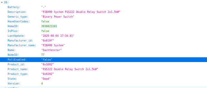

sailmich wrote: Wednesday 05 August 2020 10:31 I don't know if it would be better to open a new thread or still use this! Last update time doesn't make it (for me). Is there a way to get the node state or device.state if alive or dead? I tried my code inspired by that thread.
The Zwave state is not directly copied to the device state on the domoticz level. So this will not work.
What do you see when you enter this in your browser?
http://<domoticz ip: domoticz port>/json.htm?type=openzwavenodes&idx=<Zwave hardware ID>
sailmich
Posts: 245
Joined: Wednesday 17 February 2016 22:55
Location: Germany
Re: dzvents get hardware (not device) last update time
Post by sailmich »
Bildschirmfoto vom 2020-08-05 11-32-50.png (28.2 KiB) Viewed 2835 times
The state is dead. I read deeper in the quoted thread and saw that I have to use also a bin/bash script. Can I avoid this?
sailmich wrote: Wednesday 05 August 2020 11:36 Bildschirmfoto vom 2020-08-05 11-32-50.png
Yes give me some time to adjust the dzVents script. Can you please share the complete json output as plain text between code tags?
Use PM if you don't want to share it here.

idx	"37"
sailmich wrote: Wednesday 05 August 2020 12:03 Too many characters for the whole json. Let me know when you need more information.
Could look like below
local hardwareID = 2 -- change this to hardwareID of your zwave stick
local scriptVar = 'getZwaveNodes'
return
    on =
        timer =
            'every minute', -- set to required frequency or remove
        devices = {
            'Z-Wave node status',
        httpResponses =
            scriptVar,
    logging =
        level = domoticz.LOG_DEBUG, -- set to domoticz.LOG_ERROR when all is OK
        marker = scriptVar,
    execute = function(dz, item)
        if not item.isHTTPResponse then
            dz.openURL(
                    url = dz.settings['Domoticz url'] .. '/json.htm?type=openzwavenodes&idx=' .. hardwareID,
                    callback = scriptVar,
            return
        if item.ok and item.isJSON then
            rt = item.json.result
            local deadNodes = {}
            local foundAtLeastOne
            local alarmString = 'One or more Z-Wave node(s) has gone DEAD! '
            for _, device in ipairs(rt) do
                dz.log( 'Checking device ' .. ( device.Name or '?' ) ..
                        ', node: ' .. ( device.NodeID or '-')..
                        ' ==>> state: ' .. ( device.State or 'Not set')..
                        ', last updated: ' .. ( device.LastUpdate or '-' ), dz.LOG_DEBUG)
                if string.upper(device.State or ''):match('DEAD') then
                    deadNodes[device.NodeID] = ( device.Name or 'Unknown' )
                    foundAtLeastOne = true
            if foundAtLeastOne then
                for node, name in pairs(deadNodes) do
                   alarmString = alarmString .. '[' .. node ..': ' .. name ..']'
                -- dz.notify("ALARM", alarmString, dz.PRIORITY_EMERGENCY,nil,nil,dz.NSS_PUSHOVER) -- use this for notification to one defined notification subsystem
                dz.notify("ALARM", alarmString, dz.PRIORITY_EMERGENCY) -- use this for notification to ALL defined notification subsystems
                dz.devices('RED').switchOn()  --Dummy switch
            dz.log('There was a problem handling the request: ' .. item.statusText , dz.LOG_ERROR)
            dz.log(item, dz.LOG_DEBUG)
Post by sailmich »
waaren wrote: Wednesday 05 August 2020 12:57
return
    on =
        timer =
        devices = {
        httpResponses =
            scriptVar,
    logging =
        marker = scriptVar,
            dz.openURL(
            return
Once again a fantastic job from you! I will try to understand your code. Right now I use the dummy switch RED for a json command to reboot the system. I will try to add some code just to refresh node information for the dead node instead of reboot the system. THX again!
