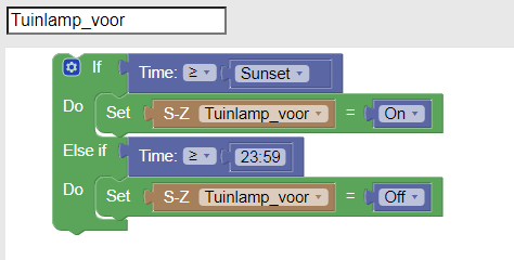

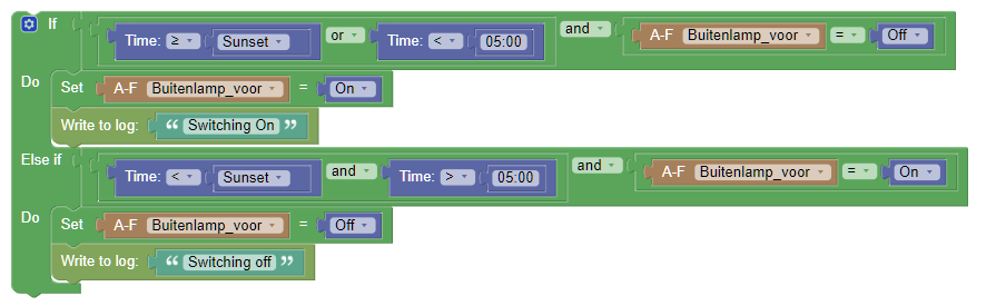

I have 2 scripts of two lamps.
The first one is called: Tuinlamp_voor and this is working fine (Tuinlamp_voor_OK.png)
The second one is called: Buitenlamp_voor and this one does not work at all. (Buitenlamp_voor_NOK.png)
Both scripts are exactly the same .
There is only 1 difference.
In the first script the end time is 23:59
and in the second script the endtime is 05:00
I can not figure out why the first one runs very good and why the second one does not even start and so does nothing at all

Re: Why does one script not work while they are almost exactly the same??
If you look at the "Buitenlamp_voor" the sunset time is always after the 5:00 time as well. So it will turn on your light and immediately turn off due to the Else if. Your assumption is that the 5:00 is for the next day but it's also applicable for the same day

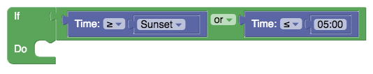

Try
because time after sunset is > 05:00
I was a bit late
I was a bit late

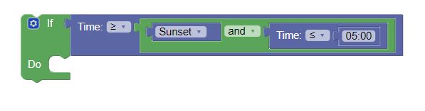

- waaren
- Posts: 6028
I guess you need both..
rick8245
- Posts: 74
- Joined: Wednesday 22 April 2020 15:59
Guys,
thanks for the scripts.
I tried them both and the script of Waaren works exactly like I want.
Thanks also to Jkimmel and MikeF.
Regards,
Rick
