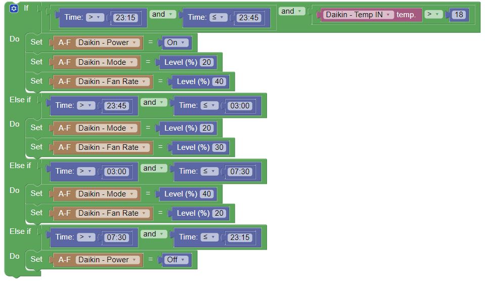

I am using a simple blockly program for controlling my Daikin airco. The program has four timing schedules. The first switch on the airco in de mode cooling and with a Fan Rate, the second schedule sets the Fan Rate to a lower level, the third schedule switches from cooling to fan with the Fan Rate Silence and fourth schedule switches off the airco for a period of time. Every night my Domoticz service exited (is stopped) around the same time as the airco switches from cooling to fan. I've ruled out other possibilities in stopping the Domoticz service so my guess is that there is something in my blockly program that causes Domoticz to stop. Perhaps there is someone who could help me with this problem.
P.S I have a similar blockly running for switching on bathroom light after moving detection with different light strengths

Your first else if can never be true.

Hello, can you explain a bit more?

It can never be later than 23:45 AND before 3:00, you need to use OR for this one.
Besides that, that can't cause the crash. Why does your system restart at 3:00?

It's the reason why I posted this question. I've ruled out other possibilities. The Daikin blockly makes the domoticz service to stop at 03:00 so it's not restarting only domoticz stops.
I wil test your answer and let you know the result, thanx

#2 0x00270c24 in sleep_milliseconds(long) ()

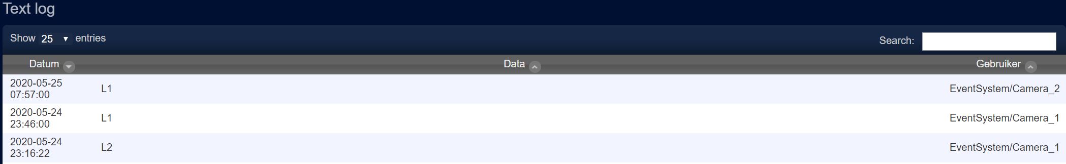

When reviewing the log of the switches from the Daikin I noticed some strange issue. It looks like that another event (Camera) is influencing the Daikin event.
- Daikin textlog fan switch.JPG (55.17 KiB) Viewed 1145 times
